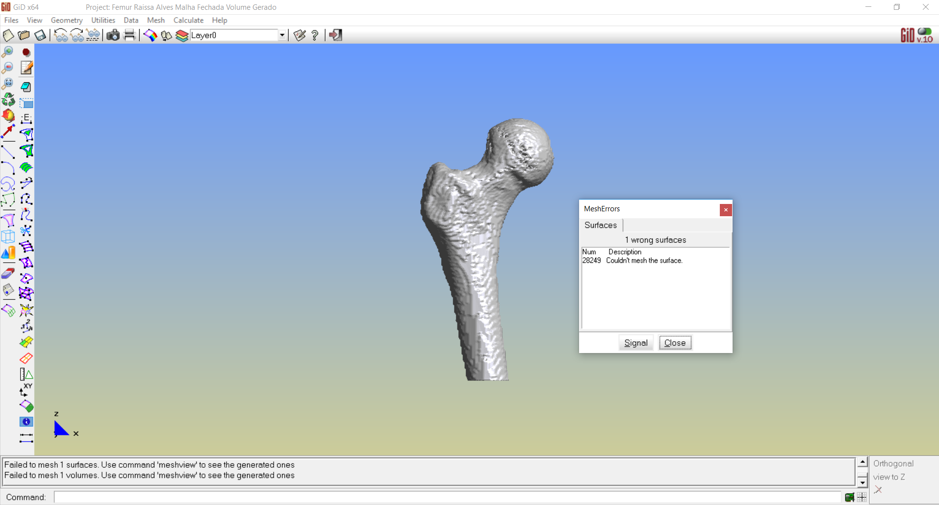

I am a new user of the GiD software, I have access to GiD 10 and some throubles in the mesh generation process are arising but I don't have a clue on how to solve it. So I'll explain what I'm doing and the problem.
I extracted a thigh bone geometry with Invesalius software. In Rhino 6, I've fixed the STL file incompatibilities errors, thus, generating a closed mesh of the thigh bone geometry. I saved the mesh as a STL file and imported it with the GiD 13 (in the lab I work there are other GiD versions available), then I used the command "Geometry >> Create >> Geometry from mesh >> one element-one surface" to generate the geometries I needed, the volume was created using the "Geometry >> Create >> Volume >> By contour" command.
Then, I opened the project file in the GiD 10 to generate the mesh. I assign the tetrahedral element type to the volume and then click on the Mesh generation option, with the "get meshing parameters from model" option checked, then the size of the elements are assigned and the "Ok" button is hit. I've tried this process with different sizes, from 9 to 0.05. The software starts the meshing process and, abruptly, stops near the surface mesh procedure is complete with the same error message: " 28249 Couldn't mesh a this location".
* I've tried to assign the element size as 0.01 but the procedure's memory requirement was beyond my computer's memory affordability.

By your image, the mesh error message said that the surface number 28248 cannot be meshed.
have a look to this surface an modify a little your geometry. Maybe deleting this surface and/or some problematic neighbor, collapsing very close points, creating missing parts,...
Delete the volume before, to be able to delete the surface 28248. Once manually repaired the geometry, o be closed, create again the volume and try to generate the mesh.

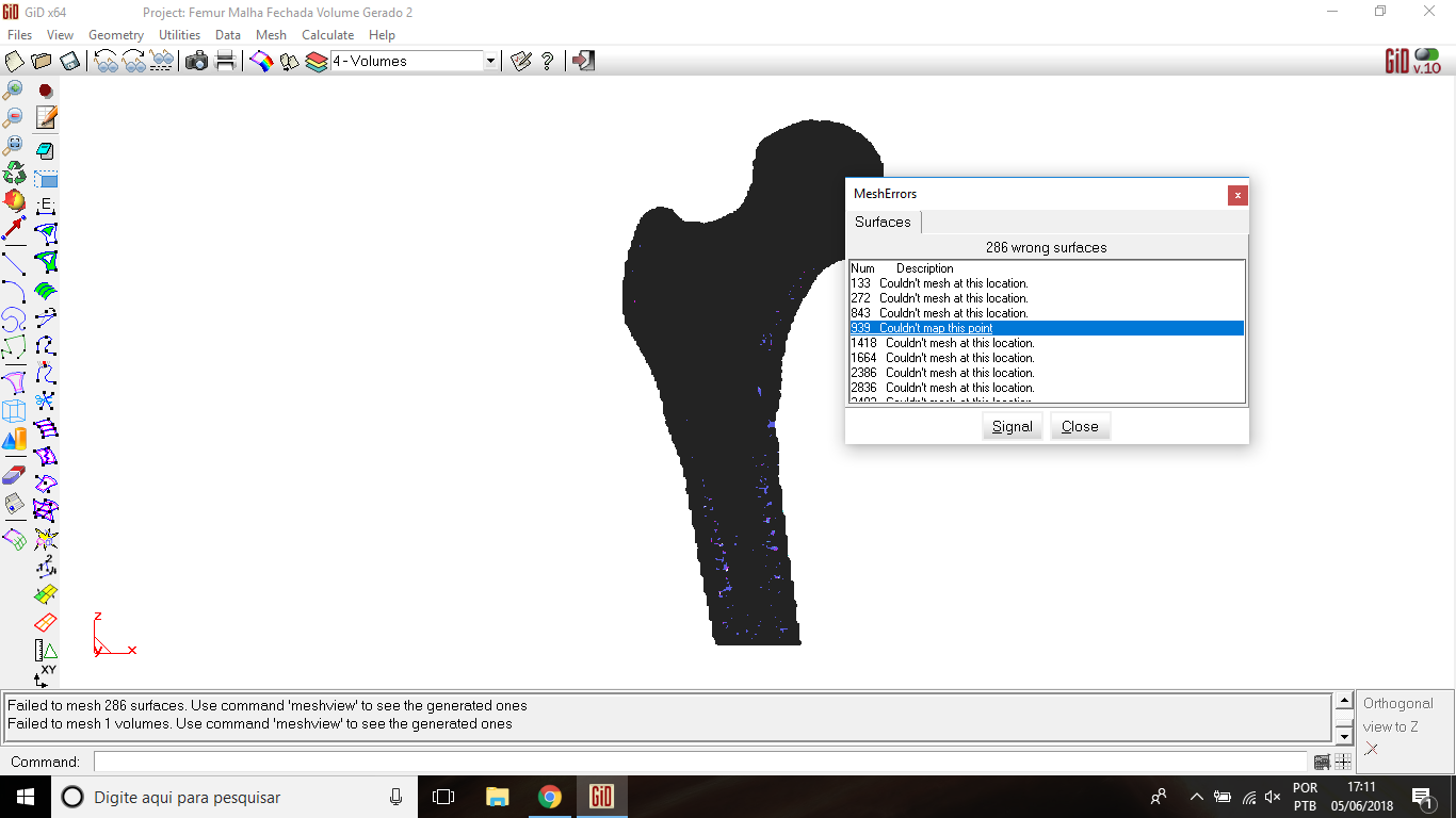

I fixed the surface which was abruptally stopping the mesh generation process. Now the process finishes the surface mesh generation and outputs another error message. The error message contains 286 error messages. since I can not upload my project here, can I send you an e-mail with it?

What is your suggestion? When the software outputs the "Couldn't mesh at this location" message, what is the problem that usually is related to this message?
I've noticed that the software output "Couldn't map this point" for some cases. Is there any solution for this kind of problem also?
Re: Mesh generation error of a thigh bone geometry
In general, if the program said "Couldn't mesh at this location" for some entity, double click on the message line to point the location, and examine the geometry (and mesh if any) on this region, and if you detect some problem (too small detail, entities overlapped, or intersection, etc) modify the geometry or some meshing parameter (assigned size or other meshing parameters).
Maybe you can upload your model zipped if do you delete some big auxiliary file, like the .msh if any or .rdr (render mesh).
Probably only the .geo is important in your case. (I don't remember the maximum size of file that could be uploaded now to this forum, maybe 10 Mb?)
If the zip file continue too big to be uploaded to this forum, you can send directly to my e-mail (escolano@cimne.upc.edu), the model or some way to download it trough dropbox, google drive, or similar.
