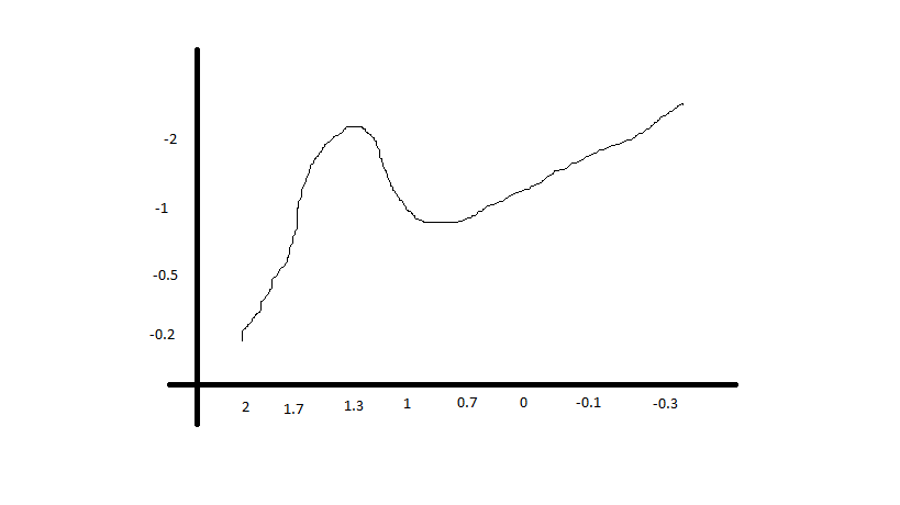

I am facing problems with Graph plot using GiD.
If I plot a variable using line graph, the graph is plot with the expected variation but the scale is different.
Example, if I plot some parameter against a distance. The values shown in the axis are different and random than the exact numbers. It exaggerates the values near the region where more variation is observed and it compresses the rest with no variations. As in the picture,
obtaining from GiD
obtaining from GiD

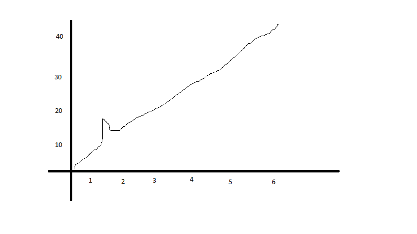

But what I need is something simple, variable values vs distance in equal divisions (similar to the picture below)
Required plot
Required plot

Please Let me know what is wrong in my procedure. Also, the point evolution curve doesn't plot anything after point selection.
