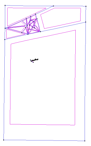

I have a question about generating a NURBS surface:
That the generated NURBS surface (by points) always be rotated automatically.
For example: 1) A set of xyz data was imported for representing the topography.
2) Then I used geometry->create->NURBS surface->by points to select all the dots for generating a NURBS surface.
(I tried to do this is because I have to generated meshes for the controlled-source EM problem which considers topography. And I want to use the NURBS surface to save the memory from millions dots to one surface)
3) press ESC to create the NURBS surface.
Then the result is shown as above figure.
I have no idea why this problem happen because I made another one successfully in several months ago. However, I couldn’t remember the flow what I tried.
Does anybody have an idea about this issue?

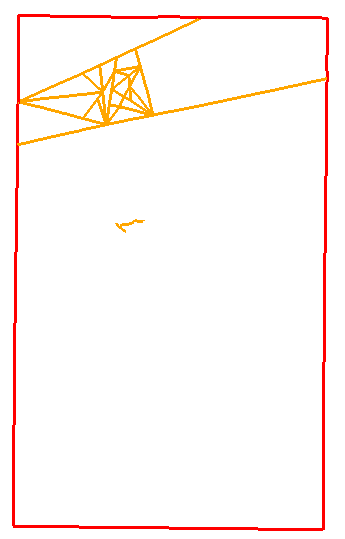

The “create NURBS surface by points” tools as first step calculate x’y’z’ local axes, and do a projection in z’ axis, and a bounding box in x’y’ axes.
To calculate these local axes is considering your points as a cloud of concentrated masses and calculate its main inertia axis.
The x’y’ could become not parallel to global xy as you expected (it your particular case were the points are inside a xy projected rectangle)
Nowadays you cannot control how to select these x’y’z’ local axes (e.g. to use the XYZ global axes like you wanted, maybe we can add this feature for next versions)
If do you want, you can try to trim the surface created, cutting it with the surfaces extruded from the rectangular lines you want.

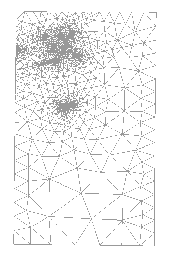

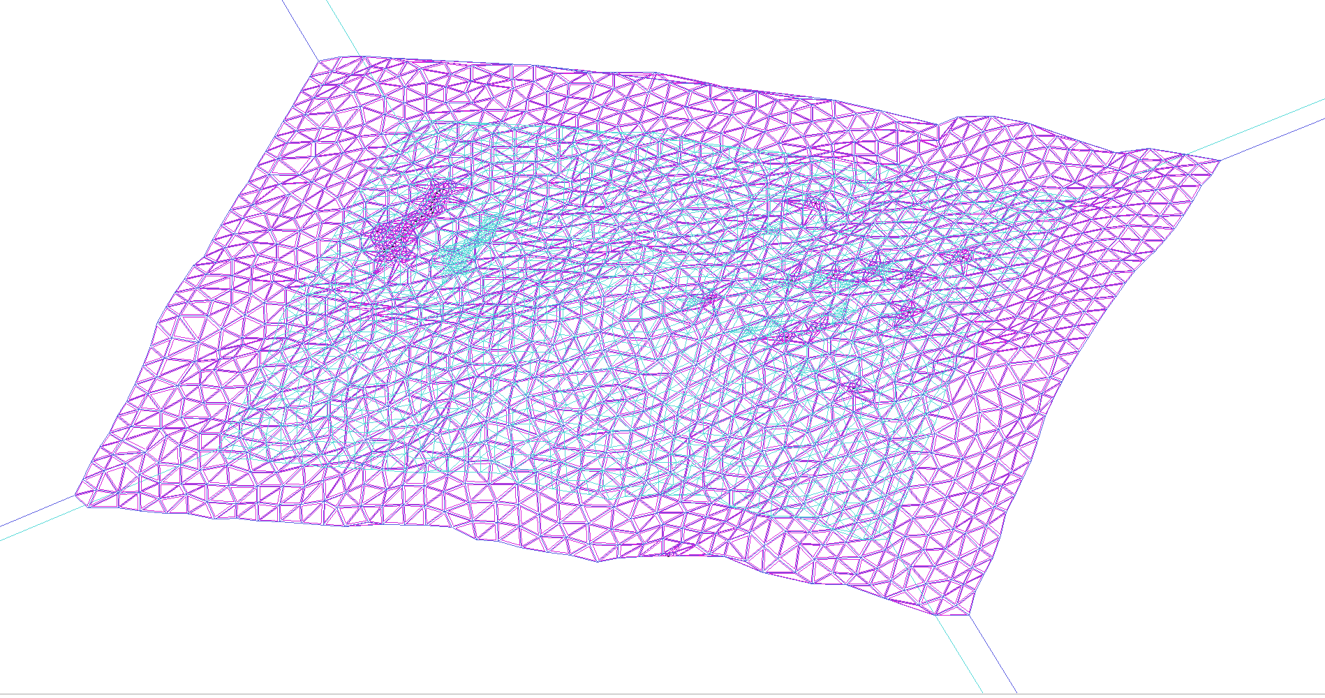

a)
The second figure which I attached in my first post was also created by GiD in couple of months ago (with a correct fitting between NURBS surface and dot data cloud), then I wander why the NURBS surface became different in this time.
As your mentioned explanation about the x’y’z’ projection, seems the new z’ is created by some interpolation method (?). Then I wander how the z’ is calculated where out of the surface cloud (whether that is close to the nearest point or some mean value from the local points). However, that may become an acceptable error for my result which I do not have to worry about, probably.

a) z coordinate is extrapolated as you pointed, with a kind of weighted average of a cloud of closed points

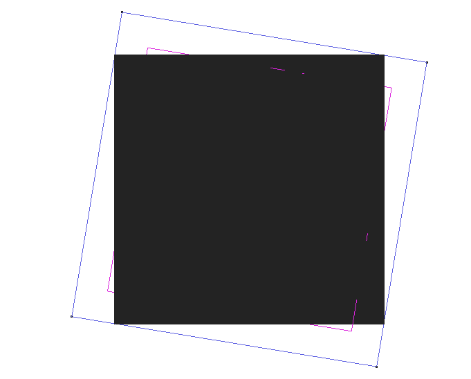

About the interesting question that how did I make that mesh which can solve all of my questions…
Well, I tried to use a smaller dot cloud, from a square shape to a rectangular shape. Surprisedly, the NURBS surface fit the shape of cloud now. I couldn’t explain the reason but it just works. (Thus, the NURBS problem is solved.)

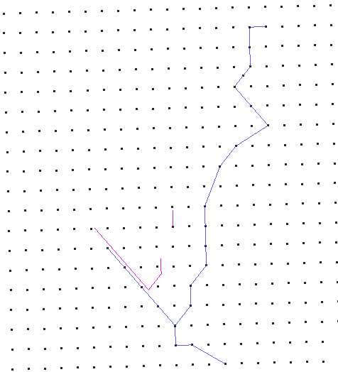

Now I am trying to follow your suggestions to combine the line with the NURB surface.

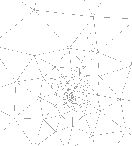

The closest result was madden by “Geometry->intersection->surface-line”
That I got the following result:
The all the dots are chosen to make a NURBS surface, and two lines (blue) are made by parts of that dots.
The purple lines are, what I think, the projected lines on the NURBS surface. The follow figure shows the mesh result which assigned the blue lines:
That we can see the result is not completely correct. I think that only part of the blue lines successfully projected to the NURBS surface.
Then I have one question about this result:
Is there anyway to draw a short line on the NURBS surface by two points? (The “Geometry->intersection->surface-2 points” will split the surface instead of make a short line on the surface).
Or, is there any trick for adjusting the result to make the blue lines fully project to the NURBS surface? (that the purple lines should have fully same shape as blue lines)

The pink lines is a way of represent the surface in ‘normal render’.
The surface is represented drawing its lines ‘a little’ contracted to ‘a center’
Usually the surface lines are only the ones of its outer boundary or inner boundary of holes.
By intersection or collapsing it is possible that finally the surface include the intersection line in its boundary definition. It is like a special hole or gap, with zero depth. The same curves are repeated twice for the surface boundary definition, once in a direction and another time in the opposite direction.
It is not possible to add this ‘kind of holes’ manually.
In fact when selecting entities, the second time that an entity is specified in become unselected. (the selection is a list of integer ids without repetition)
The surface mesh will match the line mesh of its boundary curves, but not other curves (also if in 3D space the curve is ‘on the surface’)

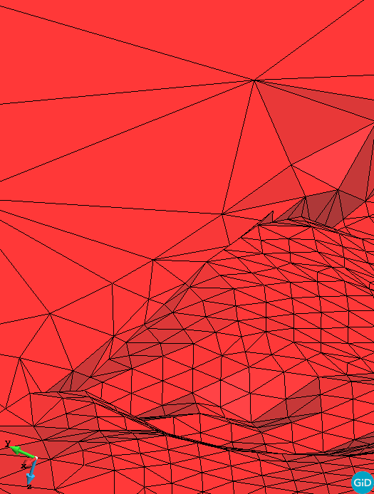

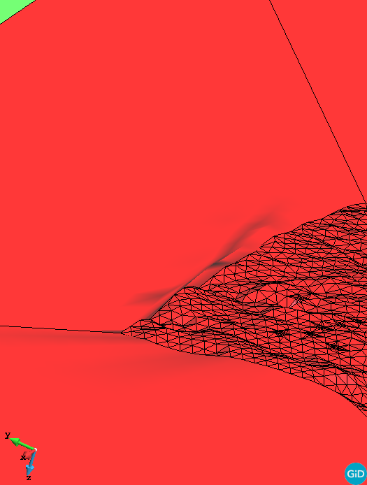

Consider the limitation of NURBs surface, I decided to move to the way for making the surfaces by lines and dots.
With giving up the resolution of topography, the geometry can still represent some rough characteristics.

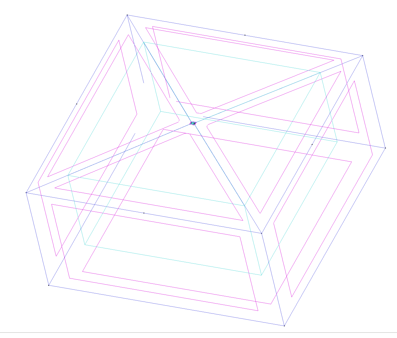

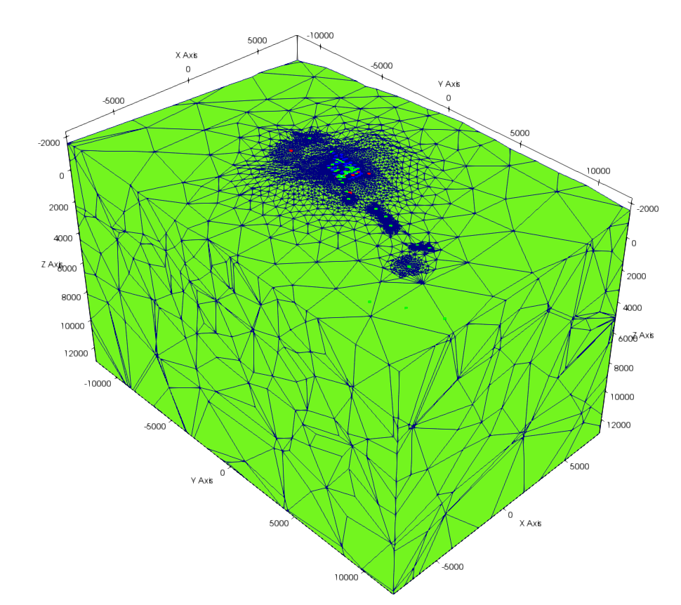

Here are some informations of my geometry design:
i. a center area which the surfaces are created by several dots with 50(size) grids (contains 12 dots [Rx] and 29 lines [Tx])
ii. an intermediate area which the surfaces are created by several dots with 200(size) grids
iii. an outer boundary area which surfaces are created by the edge lines of intermediate area and two dots at 200,000(size) away.
iv. a volume(z+) which created by i+ii+iii (as the above figures)
v. a volume(z-) which create by i+ii+ a boundary surface at 10,000,000.
I am trying to generate unstructured tetrahedral meshes for my model with the follow characteristics:
a) the edges, elements which near Rx and Tx are smaller (size of edge: <50~200)
b) the edges, elements which near the boundaries are larger (size of edge: >20,000)
c) as the z(+) increase, the meshes should be larger
d) the mesh size extremely increases at volume (z-) direction (just needs few elements)

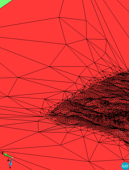

For approach my target, I tried several procedures by following the tutorial (I tried many rounds for with and without the follow steps):
  1. Mesh > unstructured > assign sizes on points > select 12 Rx dots [ to reach target “a“]
  2. Mesh > unstructured > assign sizes on lines > select 29 Tx dots [ to reach target “a“]
    for 1 & 2, the assigned size has been tried from less than 50 to 200 [between size of “i“ &“ii“]
  3. Mesh > unstructured > assign sizes on surfaces > select surface i & ii [with size 200]
  4. Mesh > boundary layer > 3D > assign > chose volume iv. > chose surface i+ii+iii or the outer boundaries
  5. generate mesh > mesh size : 1,000-50,000
In another mesh generator program “Tetgen“, I can define the super ellipse for increasing the size of elements from the center to the outer boundary, and specifically define the local ellipses for several locations.
What I tried to do in GiD is making a similar model.
However, GiD always crash in few seconds after I starting generating the mesh (as the size in 5. is larger, GiD crash as quicker).
What I guess is the program got some problem during calculating the change of element sizes from 200 to 200,000. There is no error information in GiD so I couldn’t figure out what is the real reason.

The main problem of this model is the bad shape of some surfaces (like the surface 3246 of the 3volm_beforemesh.gid),
there are self-intersections of intersections with neighbor surfaces that prevent the creation of the volume mesh.
I attach some pictures of the problematic shape, and some mesh of these surfaces.
Surface 3246:
Surface mesh:
Detail of surface mesh:
