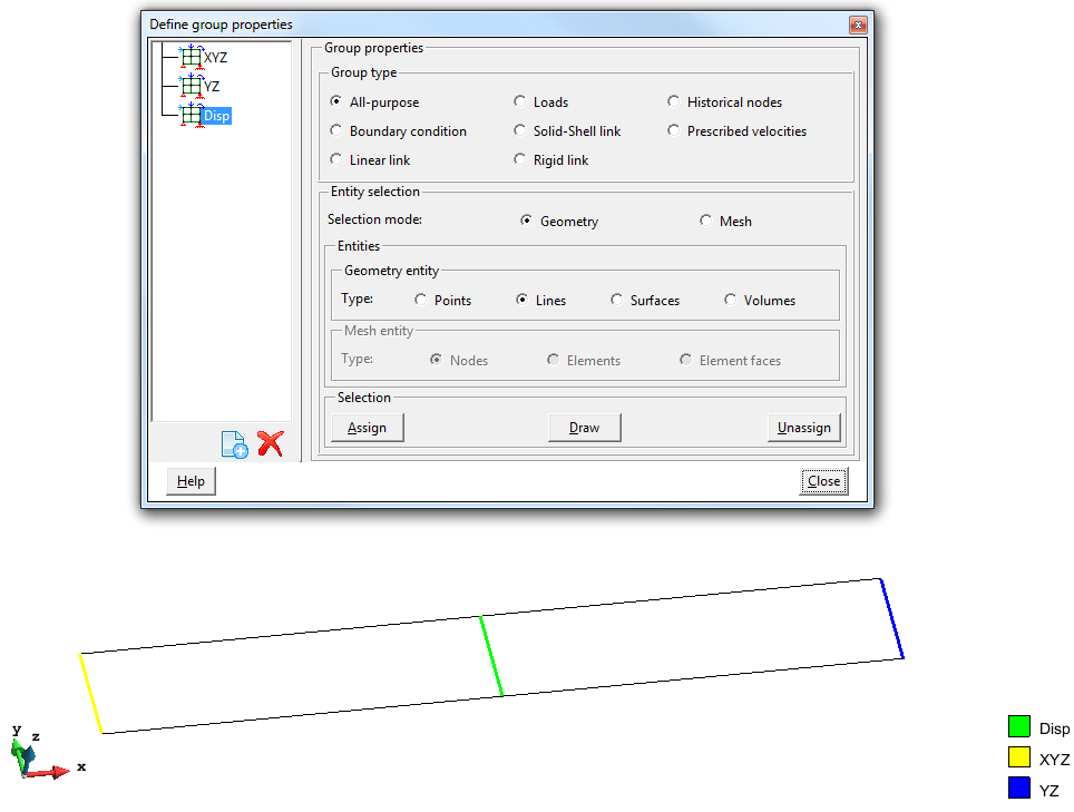

Visual representation of boundary conditions
We want to represent boundary conditions through a “Draw” button, as is done in other GiD problemtypes (i.e. Compack -see attched image-, Faust…). The problem is that we don’t know how to ask GiD the coloured geometry/mesh, nor how to include the legend with the assigned boundary condition. Do you have any ideas on how we could do this?

If you have used a ‘gid condition’ (defined in your .cnd file), then our standard conditions window
Data->Conditions…
has a ‘Draw’ button that allows draw the assigned data like your picture (e.g. by colors)
In your image it seems that the problemtype ‘compack’ is using its own windows for the condition, but to draw it invoke the standar GiD function sending to GiD_Process this commands
Mescape Data Conditions DrawCond -ByColor $condition_name -draw-
