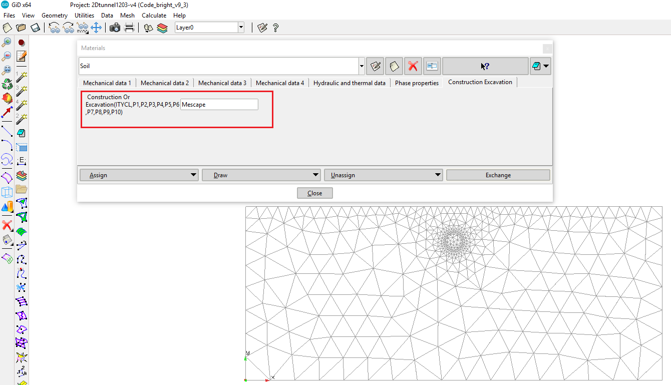

One more issue,
I edited material and saved it. Opened it again and the tabs for material was not shown properly.
Maybe another glitch in program.
Please take a look at attached file and appreciate if anyone can offer solution.
