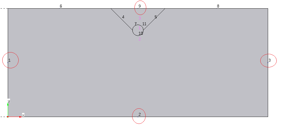

Size of force and boundary condition arrows become very small
Dear users and GID team members
During modeling by GID, by using the following tabs
Data - > Condition - > Draw → Force/Disp B.Cl
All of sudden, size of force and boundary condition arrows become very small and almost invisible.
How to reset them to initial size?
I appreciate your help.

I am using official GID V14.0.3 and problem type is Code Bright v9.3.
Problem is similar to the the tutorial example of “Strain-dependent shear modulus” in code-bright tutorial.
But it is THM model with three time interval (1st time interval is model stabilization, and the other two decrease of temperature from 20 to 14 degree centigrade.)

2Dtunnel-TEP material-THM model- CODE BRIGHT.gid.zip (3.03 MB)

It is an internal GiD bug.
The existence of dimensions (when reading the symbols from file) is affecting the scale calculated to draw the symbols of the conditions.
You can see for example that if to you delete the dimensions and save/read again the model the symbols are drawn ok.
It will be fixed in next GiD versions.
