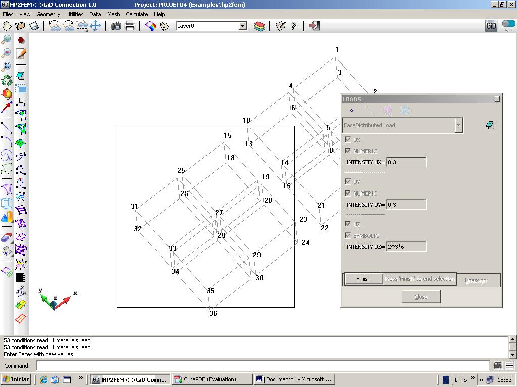

Hello
I Didn’t understand the last paragraph. I want to apply this condition on the selected volume faces for one or more faces.
If I specify in “CONDMESHTYPE:over face elements”, I can’t select the faces.
With the mouse’s left button I can delimit a area, but when I released it doesn’t keep the faces selected.
Thank you,
Oswaldo.
It seems that something is broken in latest versions and the graphical selection of faces of volume elements (tetrahedra) is not working well. We will fix it soon for next versions.
It seems that it works for surface elements (triangles:. a condition over lines → over face elements. the faces of the triangles are edges in this case)
In any case I unrecommended you to try to assign the condition directly manually directly to the element faces, the selection could be near impossible and your manual work will be lost if do you re-mesh with another size.
The appropriated way is to assign your condition to the surface and generate the mesh, then tetrahedra faces touching this surface will inherit the condition (from the conditions window you can draw and list, in geometry or mesh view, the entities and values of the selected condition to verify that they are as you want)
