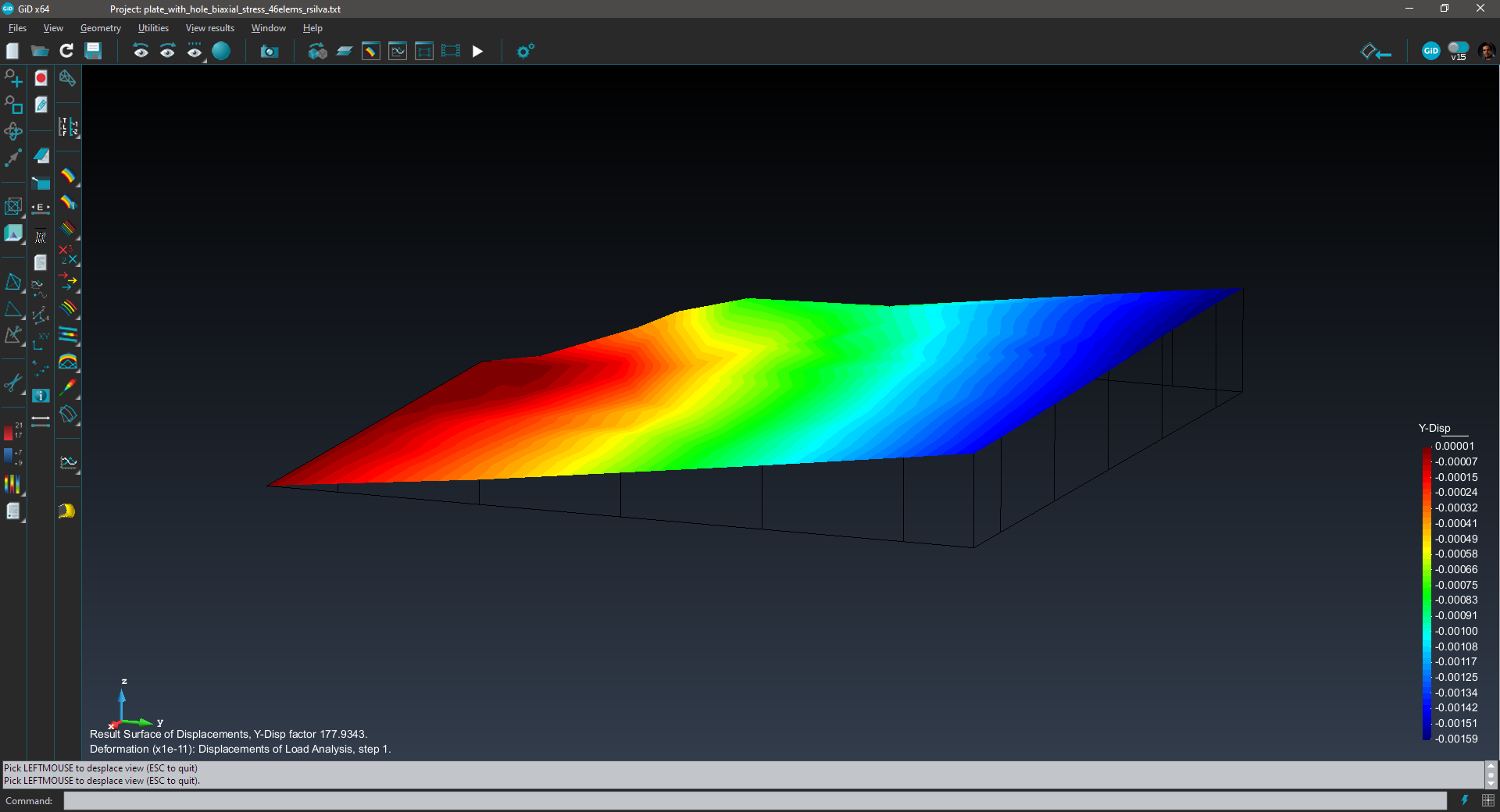

Hi, when I plot a field that has positive and negative values using “Result surface” option, the 3D plot puts negative values in the +Z direction and positive values in the -Z direction (see the attached figure). Is there any way to switch the axis so that positive values are plotted along +Z direction and negative values along -Z direction?

The “Result surface” plot is not drawing possitive values along +Z (Z global axis), but along +surface_normal_direction (+z local axis)
It seems that in your example the normal of your triangle/quadrilateral elements is pointing to -Z (its normal is defined by the order of its nodes: “right-hand rule”)

  • you can swap the orientation of a surface also in Postprocess with the option ‘Geometry–>Swap orientation of visible surface meshes’
  • or, when you use the ‘result surface’ visualization, you can enter the ‘amplification factor’ on the command line. Here you can enter negative ‘amplification’ factor, and so effectively swapping the elevation orientation.
