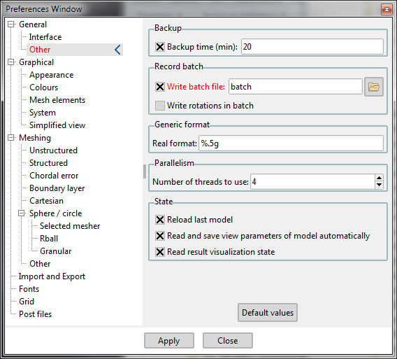

or you can record the batch of your working session on the preferences window:
Once enabled all command-line commands that you do in GiD are recorded in the selected batch file.
Including enabling the batch recording and
EVEN the QUIT command!
inside the batch file, the preferences are also saved between the
*****SAVE MARK
*****SAVE STATE
*****END SAVE STATE
lines, that you can delete for your batch.
Remember also that the batch file is rewritten every time you start GiD again and quit.
The older batch file will be renamed to YourName.bch~
best,
miguel pasenau
