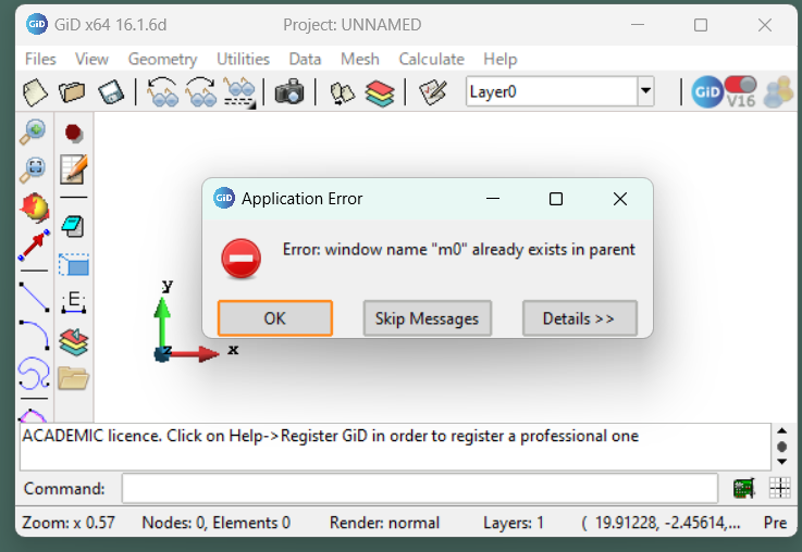

And then, if unzip testERROR.zip, in which my problemtypes are placed under the subdirectory SomeCompany/, and start GiD16.1.6.d. There arises an error:
Error: window name “m0” already exists in parent.

The error I reported has not been corrected for both GiD16.07 and GiD16.1.8d.
‘Application Error’
‘Error window name “m0” already exists in parent’
Please check again.
