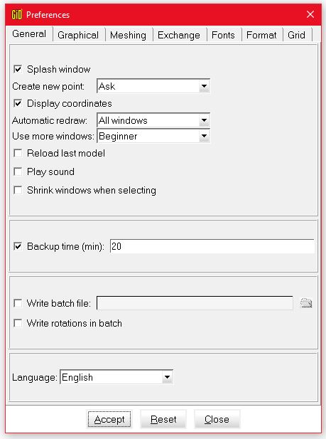

I searched for “Utilities->Preferences…
Post files->Use result cache” but I don’t find it.
I attach the jpeg of the Utilities window
According to the GiD logo in the snapshot, I guess you are using a really old version (maybe version 7?). This option is in more modern versions.
Yes, I have 7.6.6 GID version
