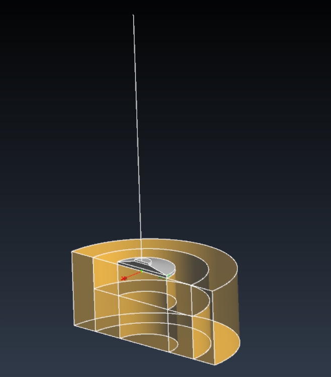

My topic is: the model is a semi-cylindrical volume of soil homogeneous sand, over the soil there is the semi-conical volume of the superficial concrete foundation of the wind energy mast tower that I modelled with a simple beam element. The structure is symmetric but the forces antisymmetric so the system is antisymmetric.
I am getting troubles meshing the model. I am using:
-Hexahedra elements for both the volumes (foundation + soil) and I tried to mesh as a structured one;
-Linear element and a structered mesh for the beam (mast tower).
What is the proper way according to you to mesh this model?
I do not refer to a specific problem cause I am getting many problems on my mesh because is the first time I do this so I’d rather ask how would you mesh it!
I attached a photo and also the GID model.

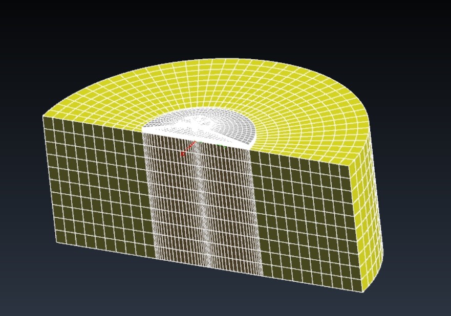

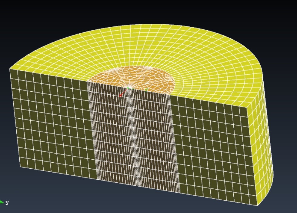

By the way, I’ve been able to mesh the model without the tower (beam element), meshing only the volumes in this way: combining structured mesh for the outer 6 faces volume of soil and semi structured volume for the inner core of soil and the foundation volume (it can not be meshed as a structural volume for its geometry).
I post a picture.
Would you have any raccomandation of how to mesh it better and improve it?
The way I meshed the problem seems to be effective, the elastic analysis gives reasonable result.
But I am still doubting, for example the top surface of the inner volume of soil, the one that is the interface between soil and foundation is not meshed radially…
How can I mesh in order to have a radial mesh in that direction?

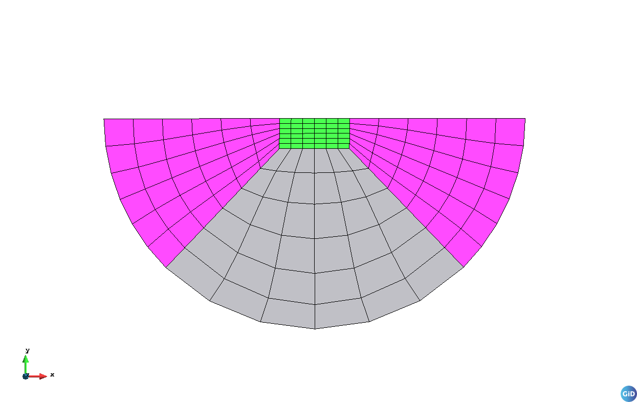

The first options seem ok,
a radial pattern is a bad option because in the pole is not possible to draw a quadrilateral, it degenerates to a triangle (a prism in your 3D extruded shape)
Note: in theory is possible to mesh a surface with triangles and a radial pattern with
Mesh->Structured->Surfaces->Center structured
(and if the automatic center is not the one you want can set it with Mesh->Structured->Surfaces->Set center)
but this structured-centered option is rarely used, I do not recommend at all.
If do you want, you can divide your geometry in other fully structured pattern, like this.
Extruding it in 3D you can create volumes that can be meshed with hexahedra fully structured (structured in the 3 directions)
And off course, for not so-simple shapes can generate unstructured meshes of tetrahedra
