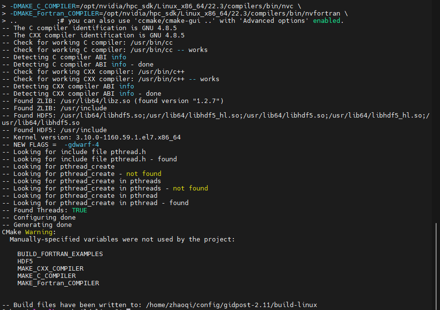

Following the reference “https://gidsimulation.atlassian.net/wiki/spaces/GPT/pages/2500165811/Compiling+the+library+and+examples”, I add the thrid part libraries into my CentOS linux and the environement variables. Acoording to the commands in the “How to build(Linux-nvidia hpc sdk)”, I need to download the file “gidpost-2.11” drived from “https://downloads.gidsimulation.com/#Tools/gidpost/” and modify the name as “gidpost”. After changing the current work direction as “../gidpost” via the command “cd”, the file “build-linux” need to be conducted by the command “mkdir”. When I run the command “cmake -DHDF5=ON …”, I obtain the warning such as “Lookig for pthread_creat - not found”. I don’t know whether they are reasonable in this step.

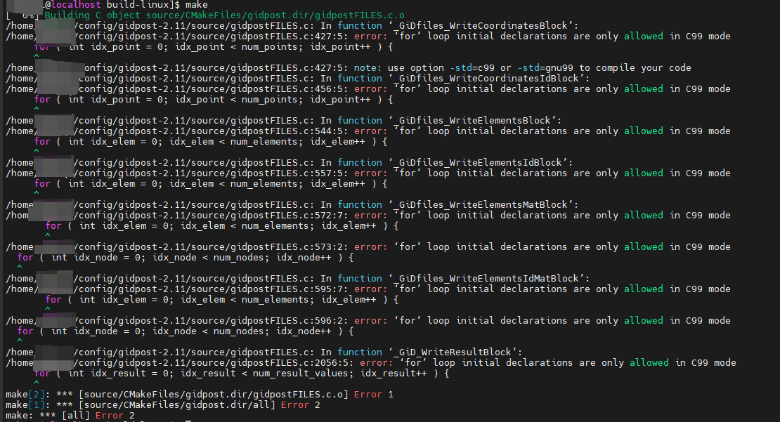

Next, I try to run the command “make”, I get some errors shown as the picutre.

About the compilation error, it seems that is because the used syntax require c99 or higher,
you can force this as a compiler flag
-std=c99
see: c - error: ‘for’ loop initial declarations are only allowed in C99 mode - Stack Overflow
