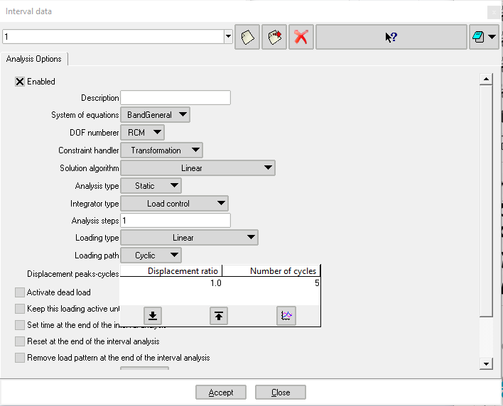

I am unable to repeat this bug with GiD 14.0
I have tried with a transform of a model saved with gidopensees 2.2.5 to the new 2.5.5
the model has only a couple of lines, the geometry or mesh doesn’t mater.
I have loaded gidopensees 2.2.5 and saved the model
then I have replaced gidopensees by 2.5.5. and loaded again the model
In my case they complain with “OpenSees path was not found” and "Windows cannot find ‘CheckForUpdate.exe’ (because I don’t have the solver opensees.exe)
but the transform seems to work, and the field of the “Interval data”
QUESTION: Displacement_peaks-cycles(Displacement_ratio,Number_of_cycles)
VALUE: #N# 2 1.0 5
maintain its value
(it is not adding extra 2 in each transform as you noticed)
I have verified it opening with a text editor the file .prb
and also opening in GiD the “Interval data” window, like the image
Please, let me know if I’ am missing something to repeat the bug
