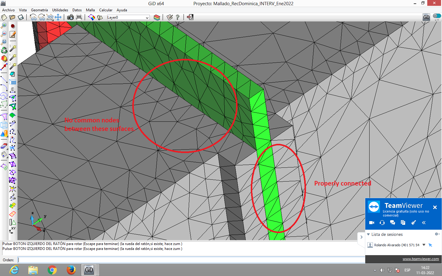

Dear escolano,
I have thoroughly reviewed the model and followed the instructions as you kindly suggested. In a general sense, there is a big improvement in the connections of mostly all nodes-elements between the involved volumes.
However, I’ve been struggling with the remaining disconnections, trying with different configurations in preferences, but still, there are certain surface not fully connected (as I attached in the documents).
Do you have any suggestions about this?
Thanks a lot for your help.
Rolando,
The mesh is not conformal in this part because the surfaces are not divided by the line and then the entities are not shared
The geometry is not connected, ant then the mesh is not connected.
You must split the surface
menu: Geometry->Edit->Divide surface->Split
And select the surface to be splitted (the gray one), and then the collection on lines that separate the surface in two regions (the lines of intersection with the green surface)
Then the old surface is replaced two new surfaces (and the volume is updated with the new surfaces)
Now do you have two ‘equal surfaces’ overlapped, to have a single surface shared by both volumes use the collapse of surfaces:
(with a small tolerance, e.g. using the default automatic import tolerance of preferences)
menu: Geometry->Edit->Collapse->Surfaces
and select the two surfaces.
