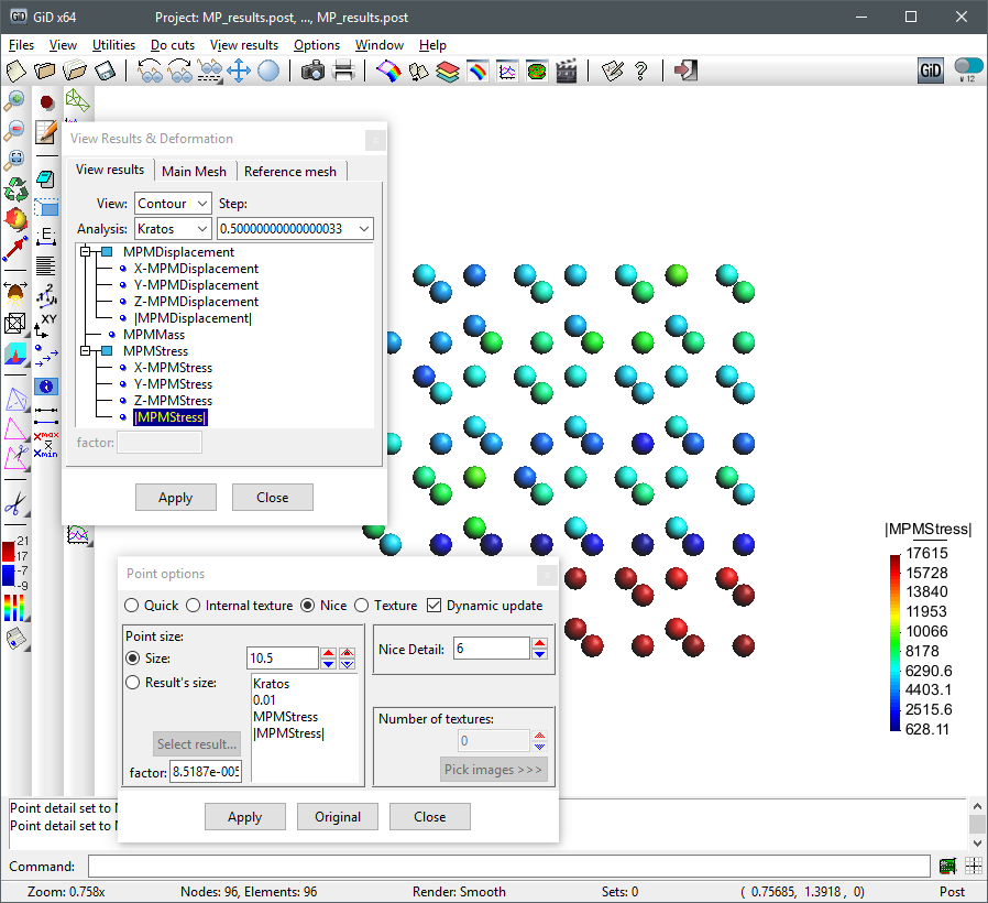

About showing results, I am able for example to show (GiD 12.0.11) this contour fill of the modulus of the vector result MPMStress
you can see that I have set a a big point size to appreciate the result.
GiD 12.x: Options->Geometry->Point options…
GiD 13.x: Utilities->Preferences… Postprocess->Mesh elements- point element options

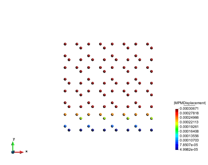

and this animated gid of a deformed result
Window->View results - Main mesh - Deformed (and select a vector result), and Window->Animate… to do and save the animation along the time steps
