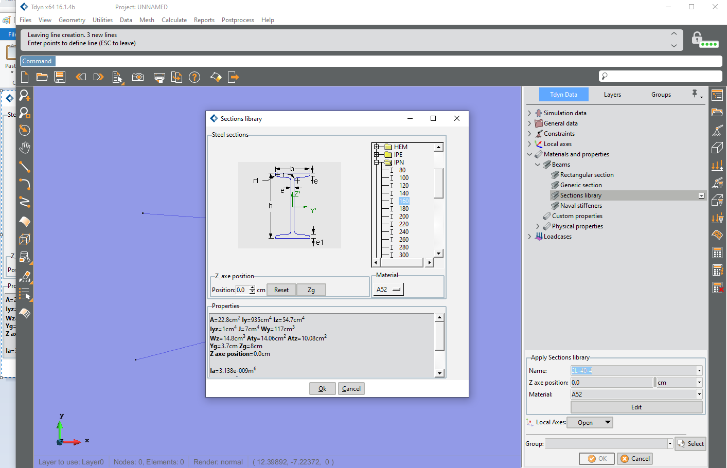

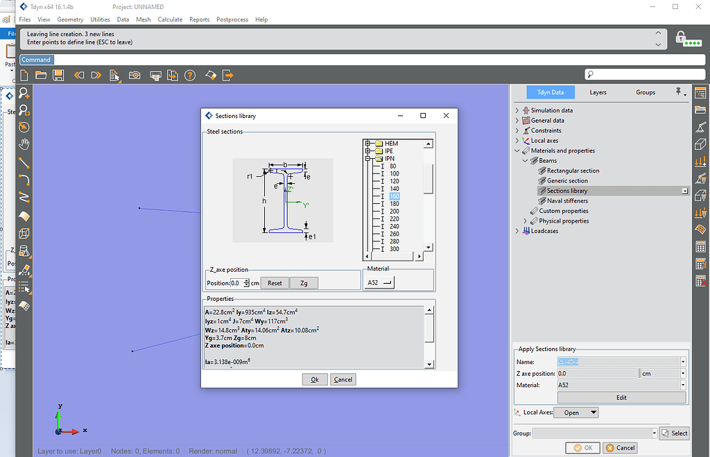

the CompassFEM-Tdyn problemtype has a catalog of sections with its geometrical properties: dimensions, area, and moments of inertia (instead of tdyn select ‘structural analysis’
