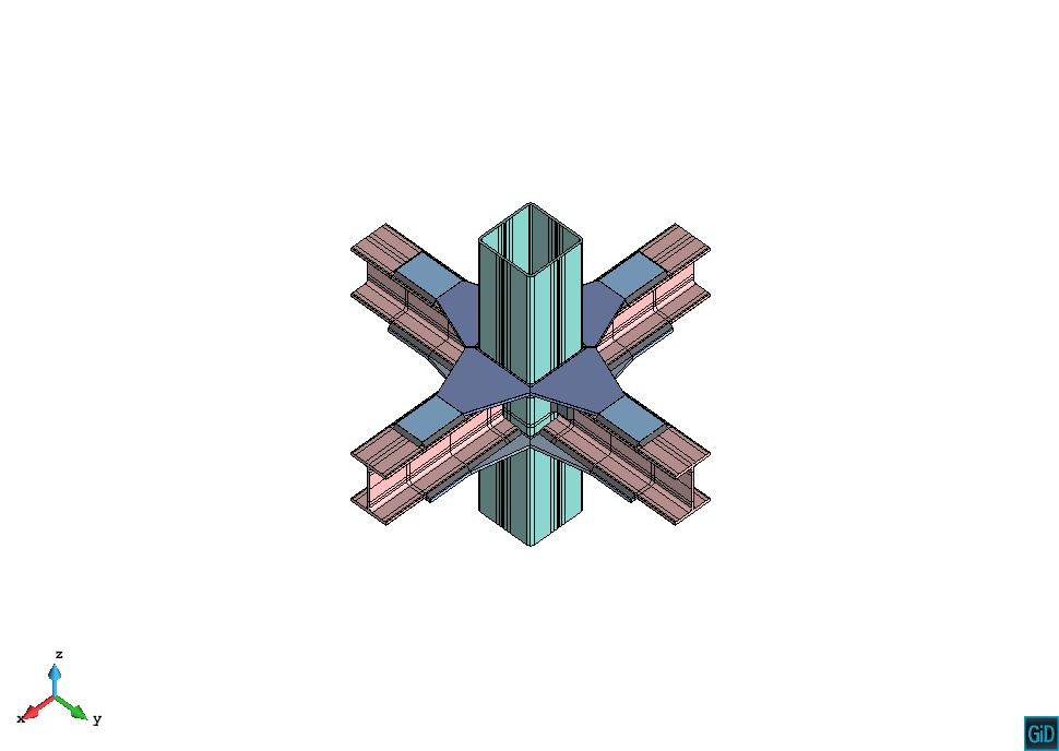

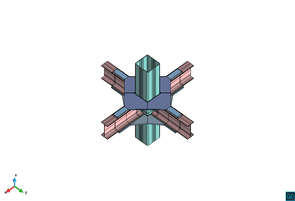

When I change “column section” or “beam section” fields, the models generated are the following:
My current code creates the connection sequentially, but I would like to make this easier (for the reasons exposed above) and generate the elements separately using a “slave code”. It is possible? Maybe using several .tcl files?
