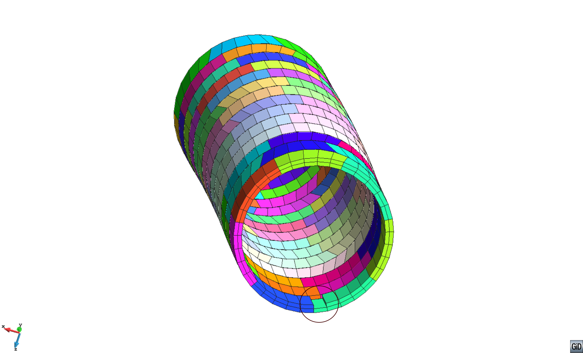

Hello
In the attached post file, the element 961 is not visible. Although a dumping of the binary file shows that the element and associated nodes are there. I can’t figure out the reason. I’m using Gid 12.0.9
Best
Giang
Bui_long_3D_0.post.zip (62.7 KB)

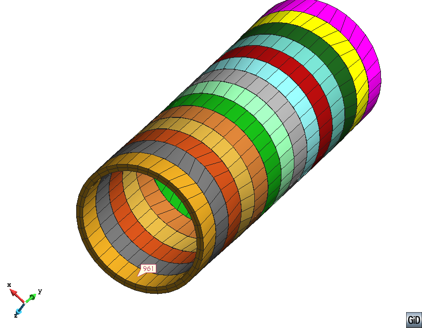

Dear Giang,

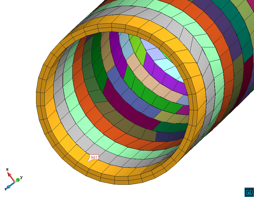

thanks for reporting the error. you are right, this is an error in GiD 12.
It has been corrected in version 13 and newer versions:
(Snapshot taken with GiD 13.0.4)
You can find our latest official version here https://downloads.gidsimulation.com/#GiD_Official_Versions/Windows/win-x64/
If you need an older version of GiD, version 13.0.4 https://downloads.gidsimulation.com/GiD_Official_Versions/Windows/win-x64/Old/GiD13.0.4-win-x64-Install.exe also has this error corrected.

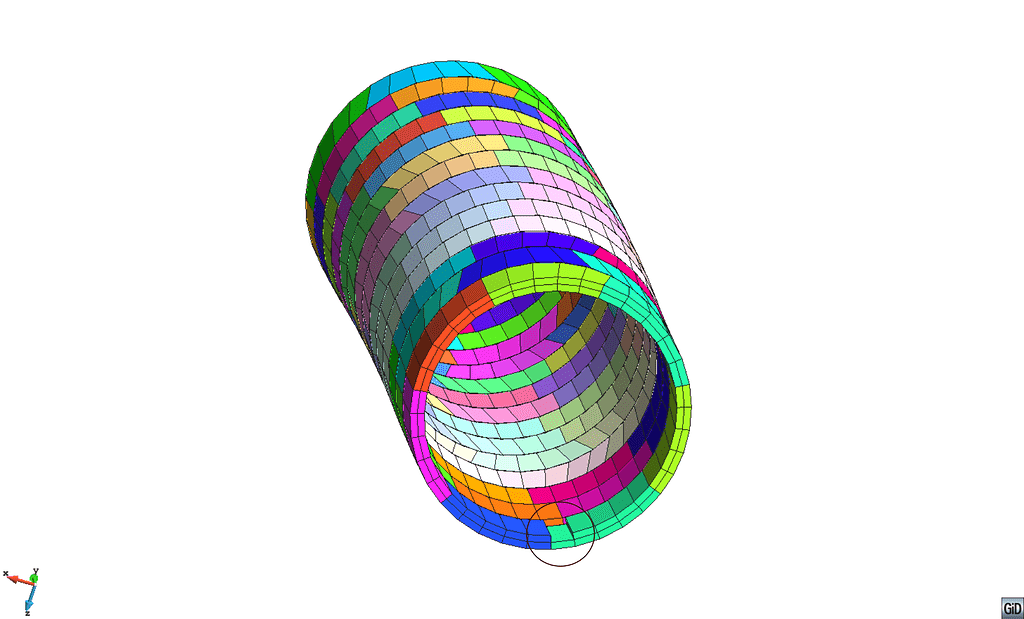

the error is a gid internal one, related to using that many sets, that has been solved in the following versions.
Using less sets the element is read correctly:
Your model for gid 12.0.9 :
Bui_long_3D_0-less-sets-2-post-bin.7z (42.8 KB)
i would suggest you to use the latest version 16.0.2:
https://downloads.gidsimulation.com/GiD_Official_Versions/Windows/win-x64/GiD16.0.2-win-x64-Install.exe
or use the version 13.0.4 which has this error corrected:
if you are forced to use GiD 12, then i’ll suggest to use less sets.
