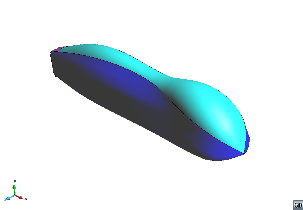

In particular, the trimming lines in this case are curves parallel to curves u=constant and v=constant, then it is possible to build a untrimmed surface, dividing the total closed surface (blue dark+cyan+pink surfaces) into three surfaces.
The pink part is similar to the original surface, but in this case is untrimmed and not closed, then is much less problematic to be meshed.

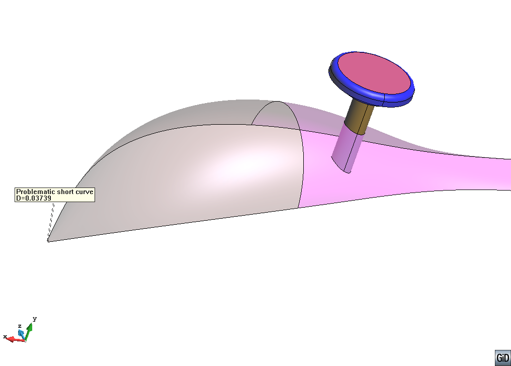

I just encountered another problem: the intersection between the pink surface and the blue tube fails, the result is that, after intersection the pink part disappears and cant be meshed. My goal is to mount the blue tube onto the pink surface to make them a continuous surface (so that the surface is conformal). My method is to intersect the blue tube with the pink surface, and then delete two redundant surfaces, one is a small pink circle inside the blue tube and the other one is a segment of blue tube in the inner side of the pink surface. I failed because the pink surface required to be meshed disappeared

The difficulties to generate a calculation mesh (and a render mesh to visualize in smooth/flat render mode) of the surface are related with the ‘too short line’ number 1145 (near the maximum x).
If you really don’t require this detail a solution could de collapse its points to delete it.
After intersect the surfaces, the pink surface must change from untrimmed to trimmed, because is holed by the tube (and the trimmed case is more difficult that the untrimmed one for several algorithms)
Another way to avoid the problem is divide the pink surface to isolate the problematic (short line) in a untrimmed surface, and the part to be intersected in another surface that will become trimmed, but at least doesn’t has the ‘short line’ extra difficulty.
I attach the GiD model modified with this solution:
Assembly2_v32_support_v6_untrimmed_devied_antenna_v1.rar (455 KB)
