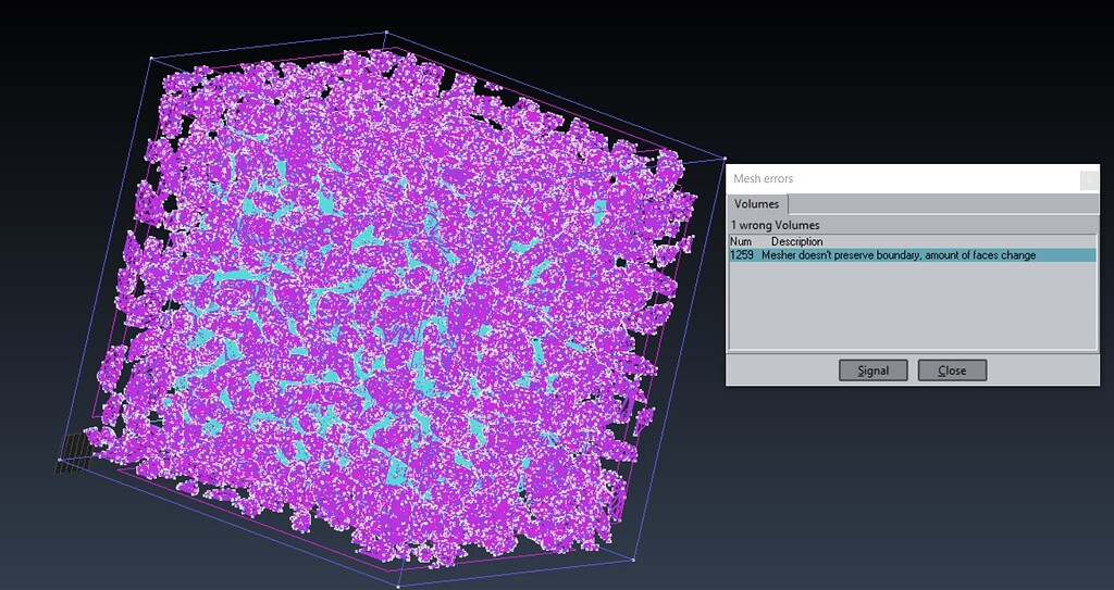

I am trying to mesh a volume with some holes in it, however, I keep getting this error message.
Mesher doesn’t preserve boundary, amount of faces change
What is the exact meaning of this error message? And what are the possible solutions to get around it?
First, I create several small volumes (which represent the holes). To make sure that these volumes have good geometry, I try to mesh them, and I face no errors in doing so. Then I erase the mesh as I do not need it.
Finally, I create a big volume and I make the holes in it using the command: “Geometry>edit>Hole volume”. This creates one volume with many holes. When I try to mesh this volume, I get the aforementioned error.
I have tried small mesh sizes and different meshers, but nothing solved it.
