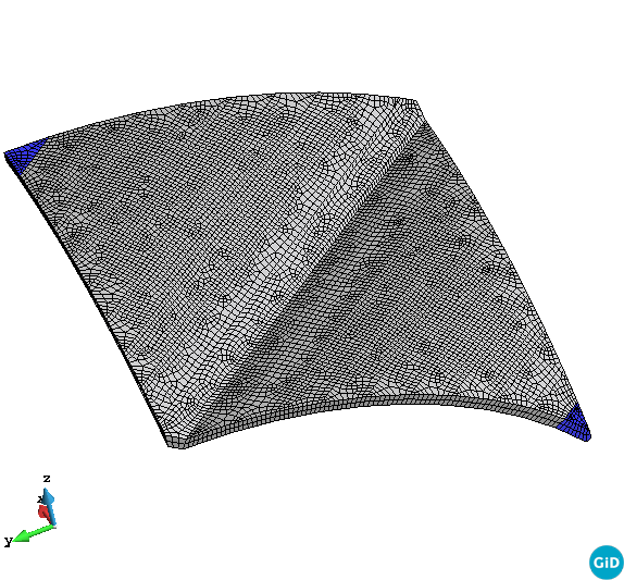

Your geometry was near to be semi-structured, all volumes are semi-structured (are a kind of extrusion: two opposite equivalent surfaces joined with lateral surfaces of 4-sides).
Only two volumes donesn’t mach this pattern: I have modified these volumes (layer blue) and now all is semi-structured
Then can mesh it with hexahedra with
Mesh->Semi-structured->Volumes->Assign number of divisions in structured direction
and I have set 2 divisions and selected all volumes
then
Mesh->Element type->Hexahedra
and then generate a mesh with some size (e.g. 0.02 in my picture)
I attach also my modified model:
volta_1_modified.gid.zip (940 KB)
But take into account that in general won’t be possible do it, only in this special case where the shape is like a shell.
