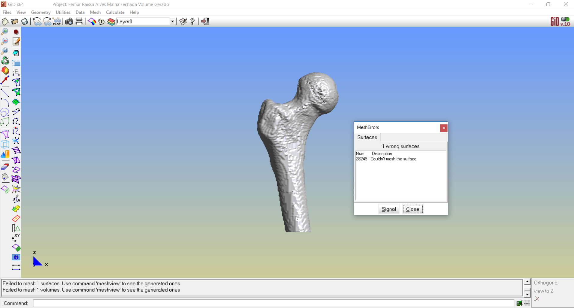

Then, I opened the project file in the GiD 10 to generate the mesh. I assign the tetrahedral element type to the volume and then click on the Mesh generation option, with the “get meshing parameters from model” option checked, then the size of the elements are assigned and the “Ok” button is hit. I’ve tried this process with different sizes, from 9 to 0.05. The software starts the meshing process and, abruptly, stops near the surface mesh procedure is complete with the same error message: " 28249 Couldn’t mesh a this location".

By your image, the mesh error message said that the surface number 28248 cannot be meshed.
have a look to this surface an modify a little your geometry. Maybe deleting this surface and/or some problematic neighbor, collapsing very close points, creating missing parts,…
Delete the volume before, to be able to delete the surface 28248. Once manually repaired the geometry, o be closed, create again the volume and try to generate the mesh.

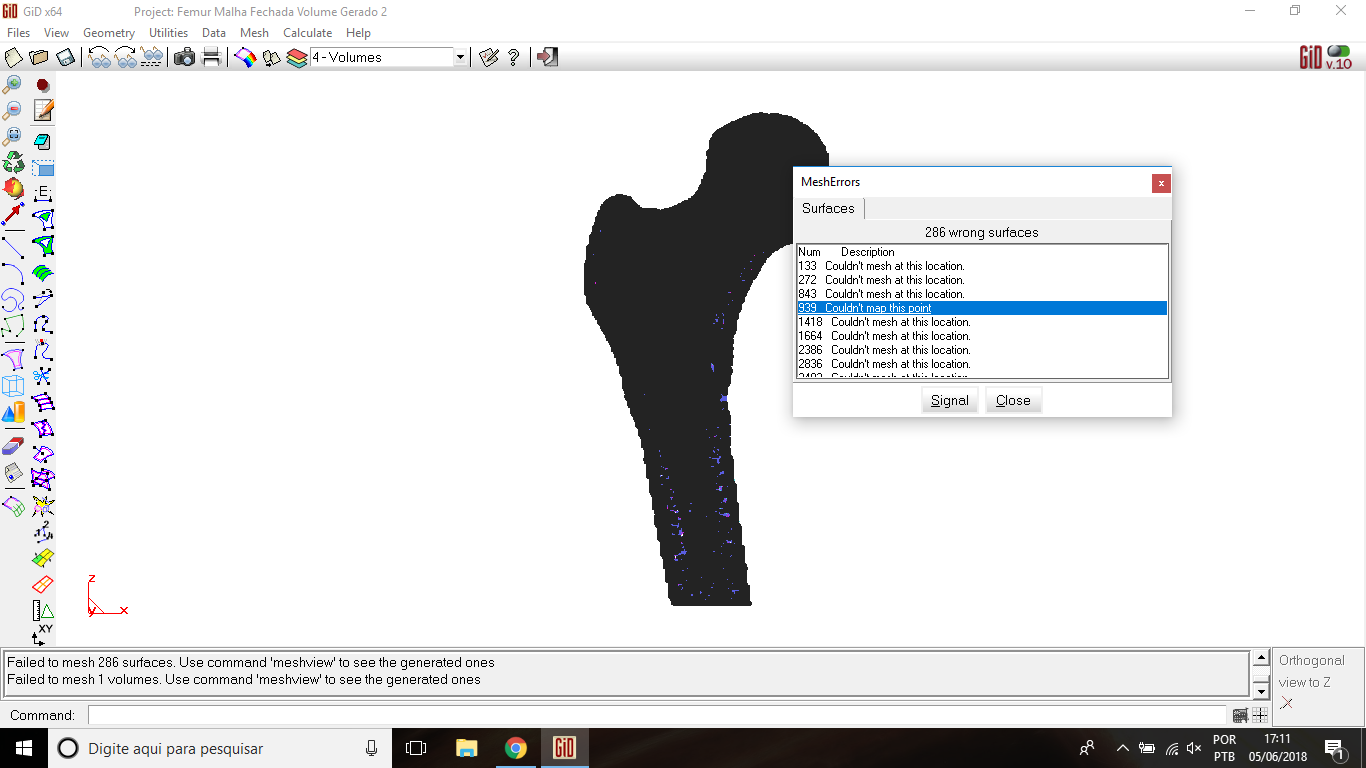

I fixed the surface which was abruptally stopping the mesh generation process. Now the process finishes the surface mesh generation and outputs another error message. The error message contains 286 error messages. since I can not upload my project here, can I send you an e-mail with it?

I’ve noticed that the software output “Couldn’t map this point” for some cases. Is there any solution for this kind of problem also?
In general, if the program said “Couldn’t mesh at this location” for some entity, double click on the message line to point the location, and examine the geometry (and mesh if any) on this region, and if you detect some problem (too small detail, entities overlapped, or intersection, etc) modify the geometry or some meshing parameter (assigned size or other meshing parameters).
