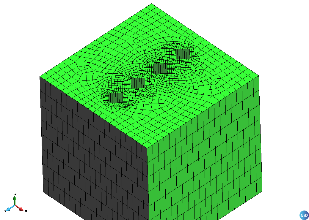

I have a cube with holes in one of its faces that goes all the way to the opposite face of the cube (images 1 and 2). As you can see in this image, I have a semi-structured hexahedral mesh. I want to concentrate the meshes along the edge of the holes but I can’t do it using the semi-structured hexahedral mesh. Now my questions are:
1- Correct me if I am wrong that meshes cannot be concentrated around the hole using the semi-structured mesh. The other option is to use tetrahedral meshes which allows for unstructured meshes and mesh concentration nearby a point or line. But the tetrahedral mesh has fewer integral points than the hexahedral mesh and if it is possible, I prefer the hexahedral mesh.

1- you are wrong. In a semi-structured volume you can concentrate mesh sizes in the surface normal to the extrusion direction, but off course must do the same concentration in both linked tops.
e.g. I have assigned a number of divisions=8 to the lines of the holes of the tops (can also assign a mesh size, but I prefer in this case a number of divisions to ensure the same mesh in the master and slave surfaces)
Note: it is better to set a number even, because a mesh of quadrilaterals is topologically imposible is the sum of edges of its boundary is odd
