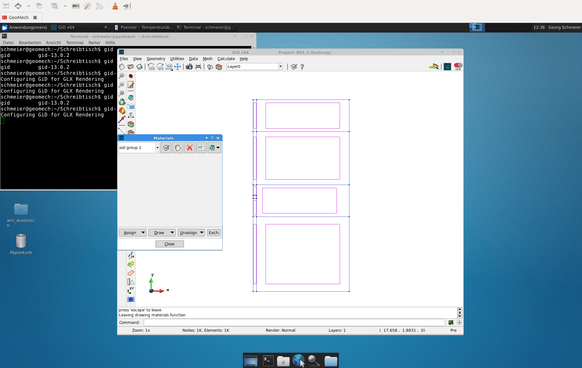

Hello I am trying to use a GiD mesh with tochnog.
But I can’t choose a material Parameter as it is shown in the GiD pdf manual on page 160.
I attached a snapshot of my desktop with the material window.
I have selected tochnog as problemtype. I am using version 12.0.3
Thanks for the Help.

In any case, the content of the ‘materials’ window is not defined by GiD, but by the problemtype loaded (tochnoc in this case)
By your image seems that tochnoc define a material named ‘soil group 1’ (or you as user have created it with this name, derived of another)
and this material doesn’t has any field to be filled. Maybe it is used only to mark some selection of entities, and don’t want attach any extra information to this material.

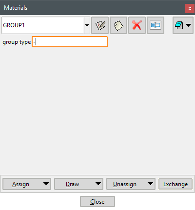

I have an old version of a problemtype ‘tochnog’ and its material named ‘GROUP1’ has the field ‘group_type’ related by its manual.
This is my screen capture
maybe your version of the problemtype tochnog doesn’t match the tutorial that you are reading.
In any case the definition of the material names or its fields depends on each problemtype, it is not a ‘GiD standard’
