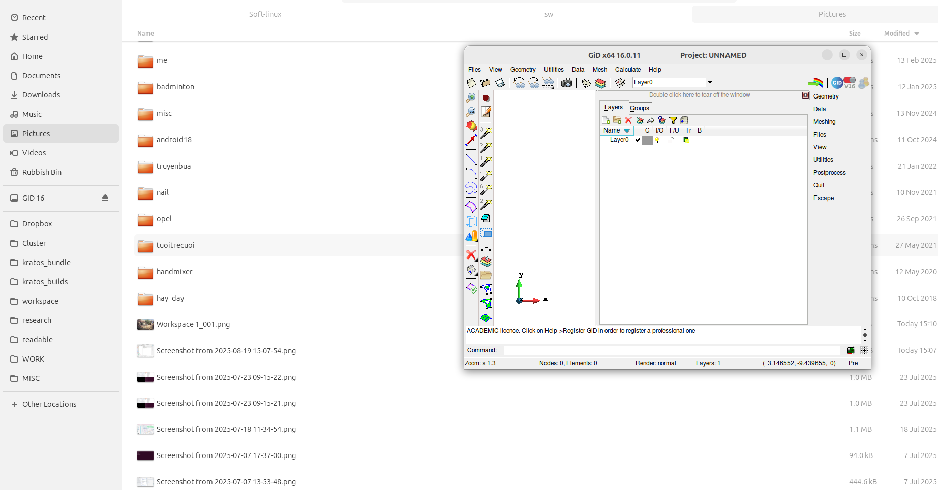

still does not work. As you can see, the USB appears, but ACADEMIC license is still active.
Ok, I mark it as a bug.
