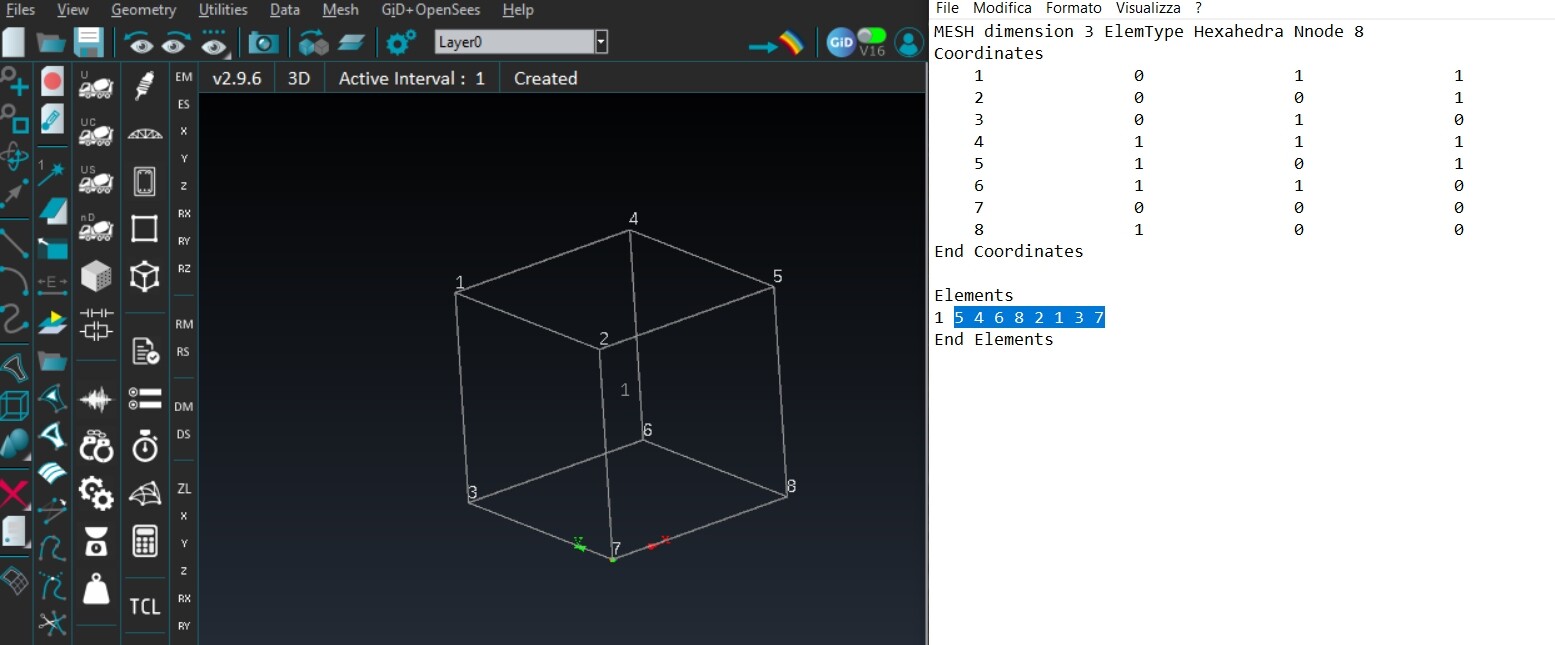

The geometry is attached, it is a little cube, just an example. I’ve obtained in output the Gid mesh file with the mesh composed by only one StdBrick element.
The problem is the cube definition. Infact I’d like to have the classic definition of the element, therefore defining the cube through the bottom and the up faces.
Why GID does the defining with the lateral faces?
My problem is not about numbering but just the definition of the cube with its faces.
I’ve also tried with extruding the cube from the bottom surface, but nothing changed.
My purpose is to apply this to a larger mesh where I need to obtain all the nodes of the up faces of all my stdBrick elements in order to apply a surface distributed load.
Marcello.
The GiD definition of finite element hexahedron linear of 8 nodes is this
It is our GiD definition, other codes like Abaqus, Nastran, etc. can use other ordering of the connectivities, and each one provide a picture with its own definition. (there is not any standar definition)
The elements can be in an arbitrary 3D position and rotation, in general the edges or faces won’t be parallel to global XYZ axis, and you must not expect any definition like first the faces ‘top’ or ‘bottom’
To assign boundary conditions lika a distributed load on a surface you must simply assign this condition to the geometrical surfaces you want, and generate the mesh and it will inherit this information (you can also directly assign it on the mesh, but is unrecommended, usually there are a lot of elements and selection is more difficult and worst if you remesh will lost your data assigned to the mesh)
