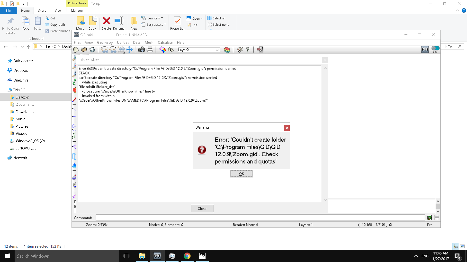

Furthermore, if I try to zoom out using the mouse wheel during this “freeze”, the following errors appear (also attached for clarity):
Error (l639): can’t create directory “C:/Program Files/GiD/GiD 12.0.9/'Zoom.gid”: permission denied
while executing
“file mkdir $folder_dst”
(procedure “::SaveAsOtherKnownFiles” line 6)
invoked from within
“::SaveAsOtherKnownFiles UNNAMED {C:\Program Files\GiD\GiD 12.0.9'Zoom}”
There is also this warning:
Error: 'Couldn’t create folder ‘C:/Program Files/GiD/GiD 12.0.9/‘Zoom.gid’: Check permissions and quotas’
Finally, the command window shows this:
Deprecated transparent syntax without ’ prefix: use 'DynamicPan instead DynamicPan
The 'Zoom.geo file that is created due to this within the C:\Program Files\GiD\GiD 12.0.9 directory is associated with another software. I feel this is worth mentioning although I doubt that that is what is causing the problem.
is because your mouse events try do do a zoom of your model that are misunderstood as the name of the model that you want to write.
some of these problems are fixed in current GiD versions.
and the other message
is only a warning that recommend (for problemtype developers) to use a syntax instead another
and probably is also a wrongly understood command related with the frozen problem.
