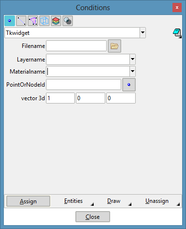

It is also possible to customize a single row of question/value and replace the standard widgets by other, with a special ‘TKWIDGET field’ that invoke a Tcl procedure that do this replacement.
As an example, in the file scripts/dev_kit.tcl there are some predefined 'tkwidget-like procedures to do some common things, like select a filename or pick some coordinate
CONDITION: Point_Tkwidget
CONDTYPE: over points
CONDMESHTYPE: over nodes
QUESTION: Filename
VALUE:
TKWIDGET: GidUtils::TkwidgetGetFilenameButton
QUESTION: Layername
VALUE:
TKWIDGET: GidUtils::TkwidgetGetLayername
QUESTION: Materialname
VALUE:
TKWIDGET: GidUtils::TkwidgetGetMaterialname
QUESTION: PointOrNodeId
VALUE:
TKWIDGET: GidUtils::TkwidgetPickPointOrNode
QUESTION: vector_3d
VALUE: 1 0 0
TKWIDGET: GidUtils::TkwidgetGetVector3D
END CONDITION

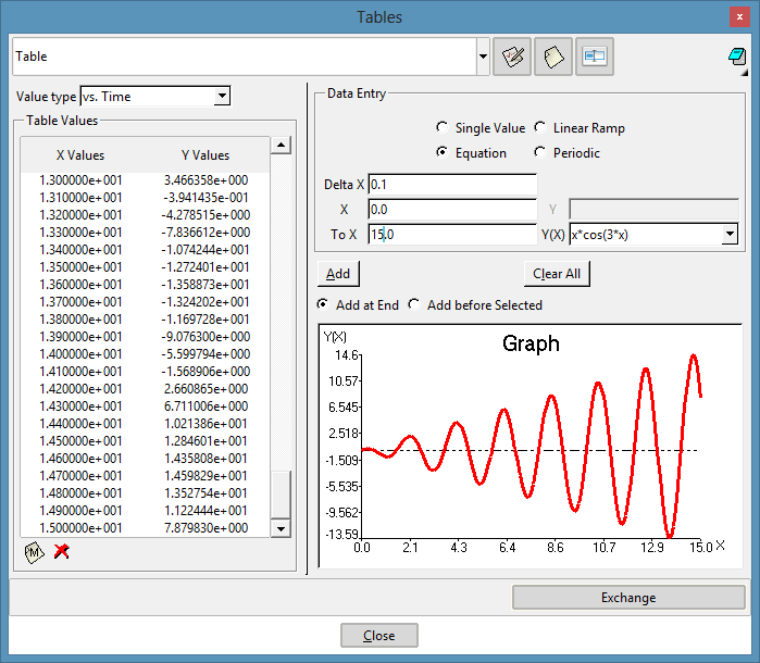

It is possible also to replace the whole content of conditions or other windows and grid inside what you want (and use the conditions, materials or problem data only to store the data), like next image of a ‘material’ window used to define X-Y graph tables (of the Nastran problemtype)
