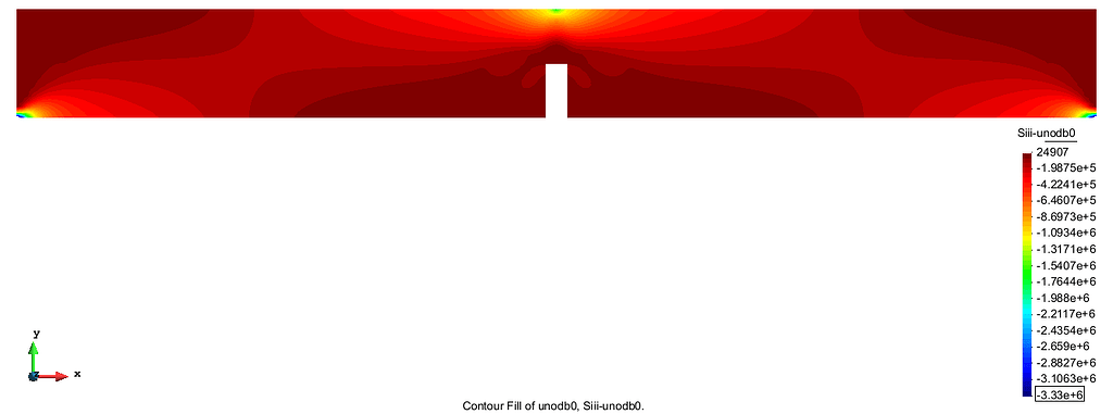

Hello, Here is my question, I have known the failure stress, and after the simulation, i want to judge the failure node, and i use the maxps criteria (could be seen in ABAQUS), However, my boss want to show the failure node label and she do want that showing the label automatically by c/c++, or any other ways instead of selecting the node by hand, So, it there anyone could tell me how to do that?
As is shown in the picture, the failure node locates at the left bottom cornor and the right bottom cornor, how to show these node label automatically?
Id do you know the node id ,then you can set of its label (or its result value if you prefer) from the lower command line
e.g. if your node is the 25 writing this:
'Label SetToOn Select Nodes 25 escape
or
'Label SetToOn Select ResultOnView 25 escape
The GiD commands could also be sent from Tcl languaje scripting, with the command GiD_Process
GiD_Process 'Label SetToOn Select Nodes 25 escape
