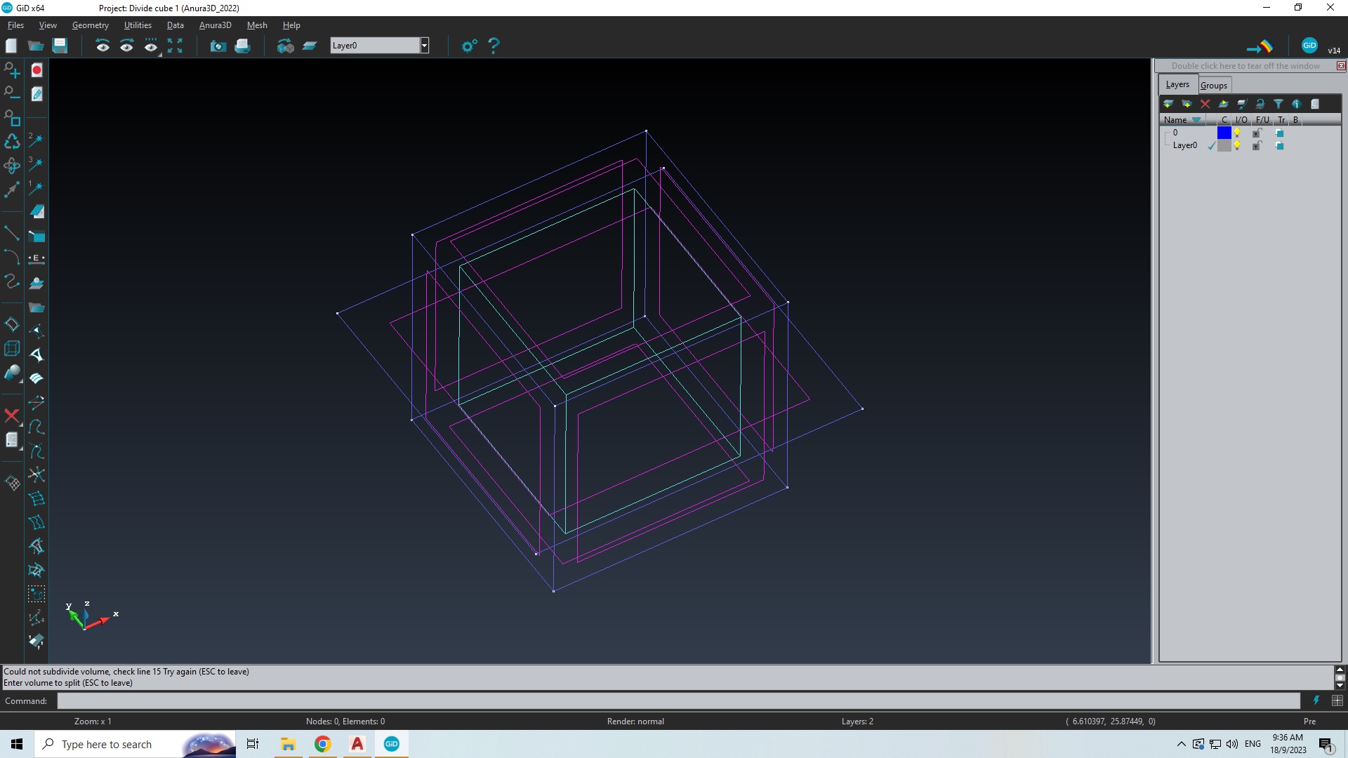

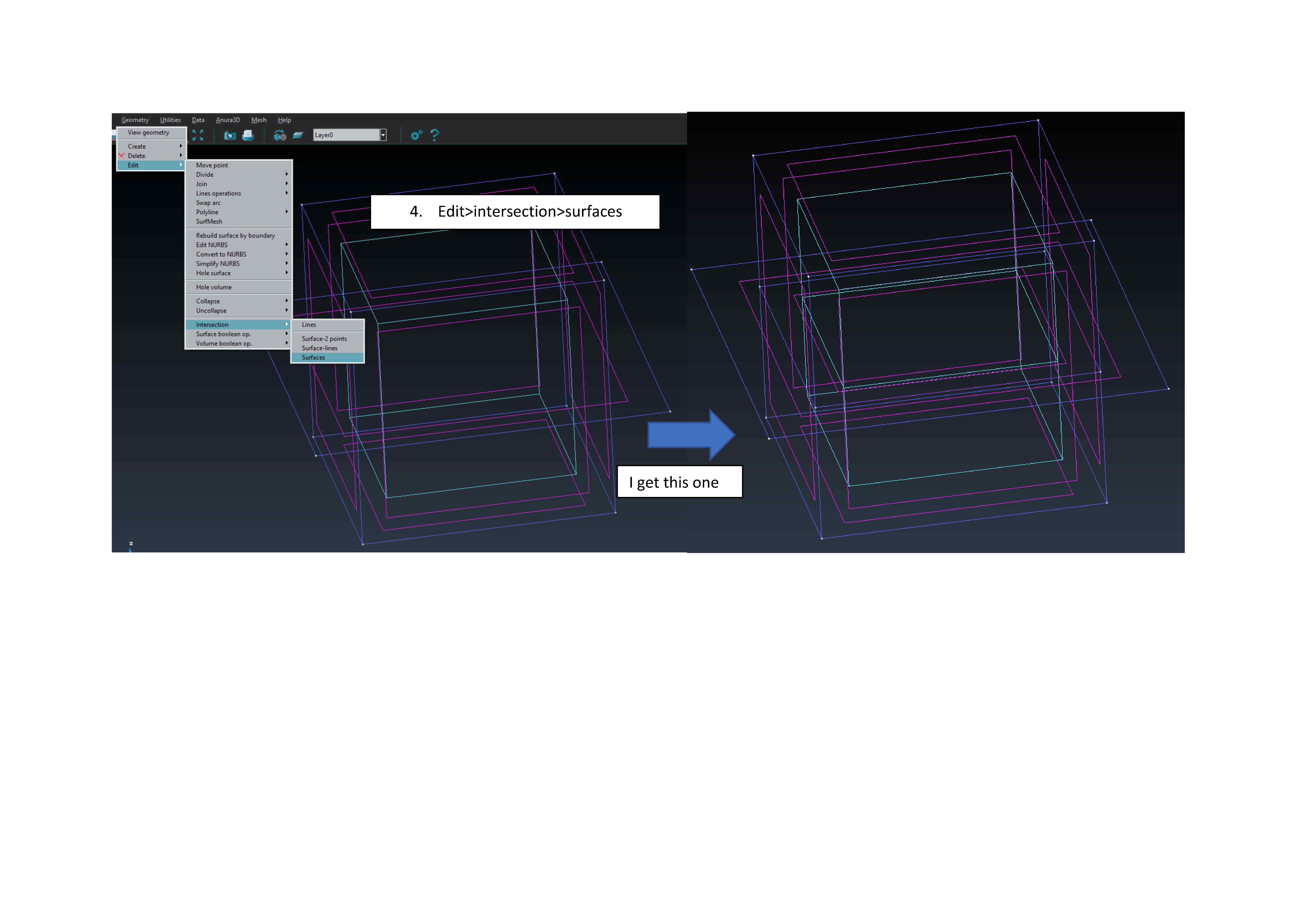

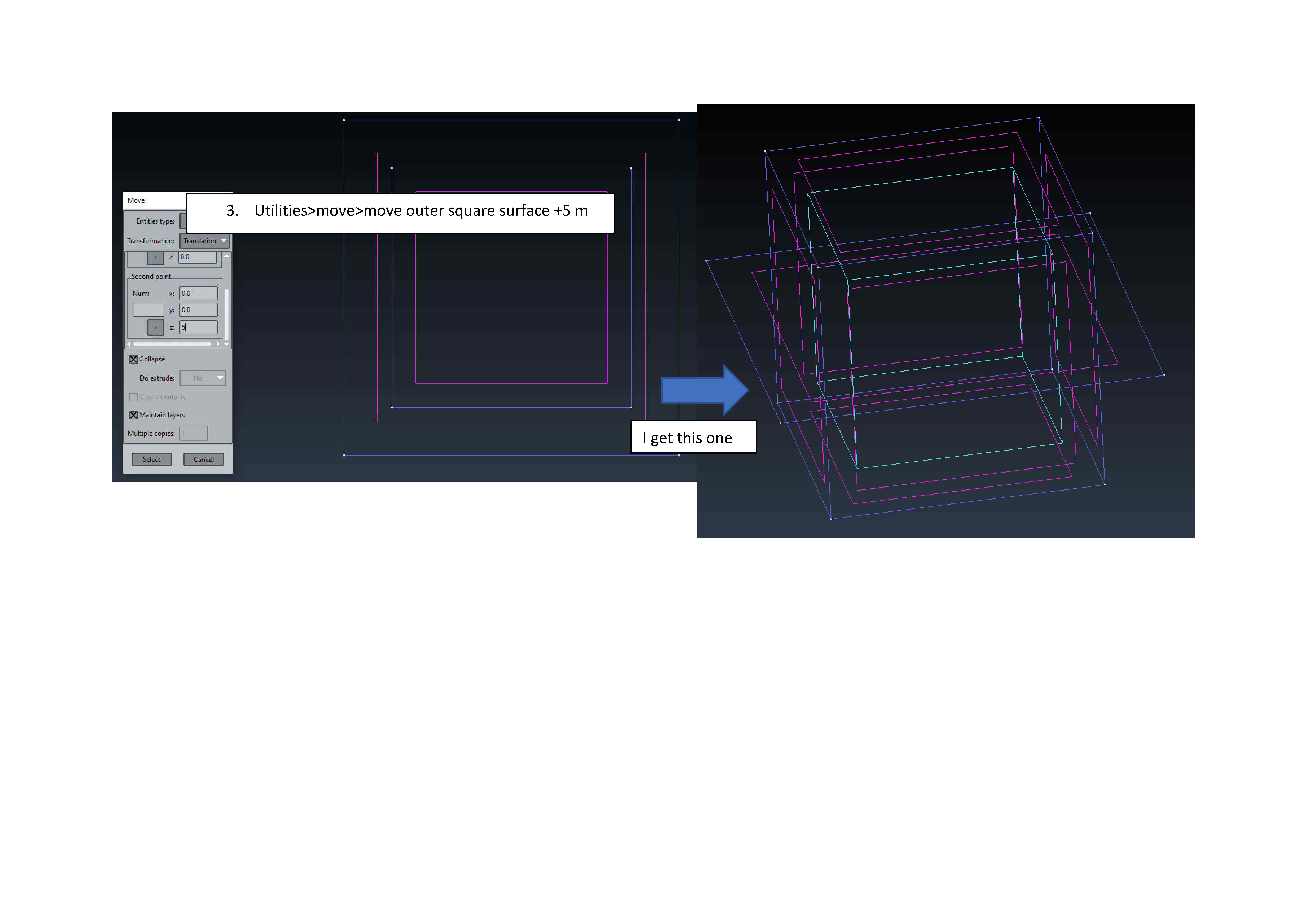

I want to divide a 3d cube by a 2d surface. The cube is 10mx10mx10m. The diving plane is 5 m above Z=0. I divided the volume via geometry>edit>divide>volume>split
But GiD said “Could not subdivide volume, check line 15 Try again”.
My questions are
  1. How to identify line 15 in my model ?
  2. How to divide the volume ?
  3. How to check if the volume has been divided into 2

2- First must divide lines and surfaces and this require create intersections
e.g.
Geometry->Edit->Intersection->Surfaces
and select the surfaces you want, in this case can select all
then can split the volume in two selecting the first the volume and then the surface in blue
3- You will see in ‘render normal’ that there are two volumes, represented by the scaled cyan curves of its boundary. You can also list the entities to know what do you exactly have.

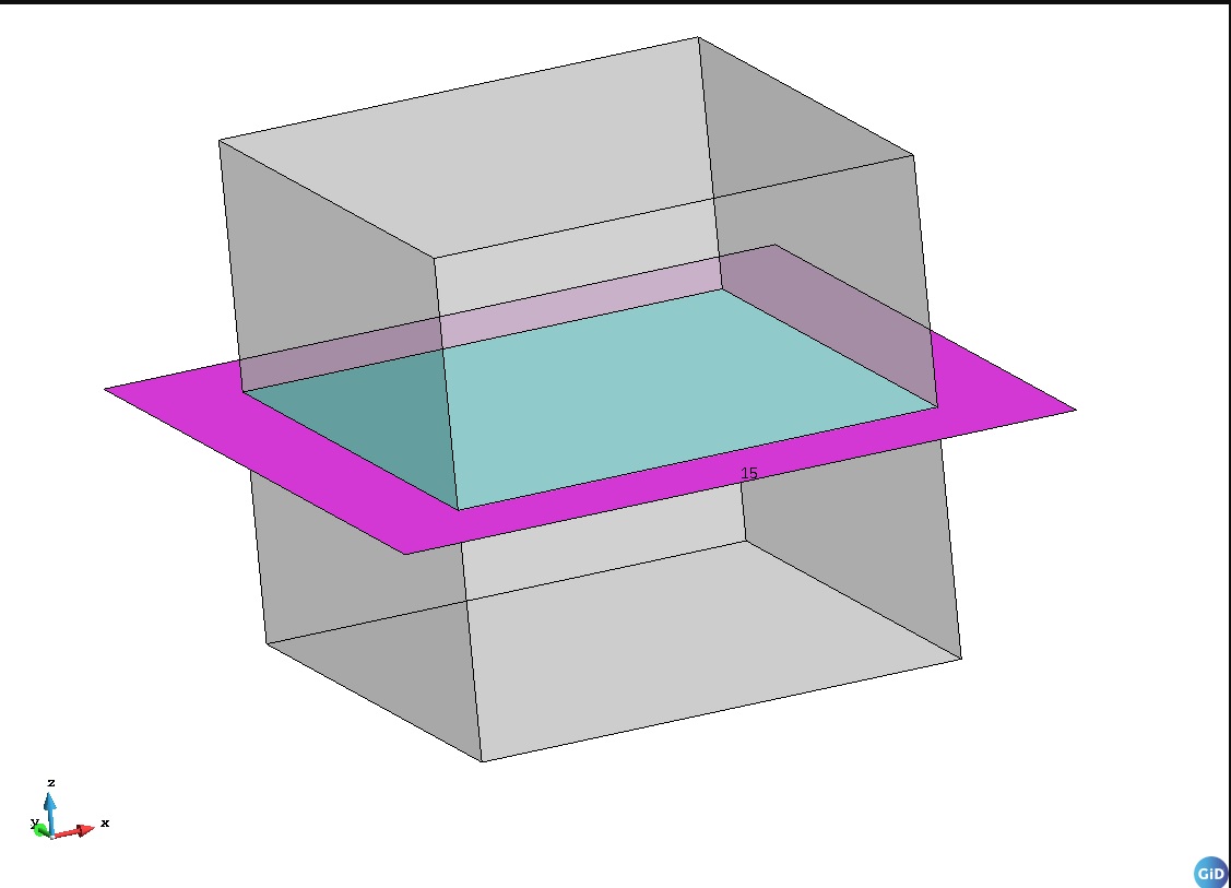

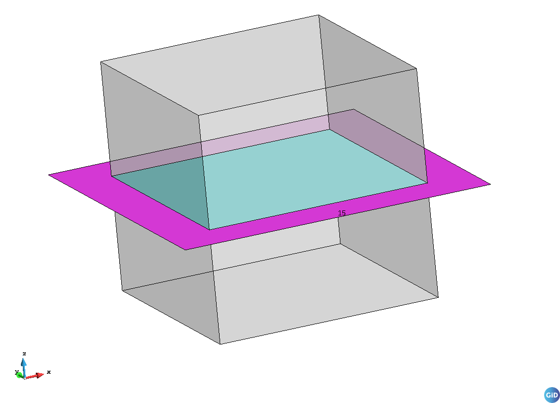

In my example, after intersect the surfaces I have send a surface to other layer, only to visually show you that the intersection of surfaces has also splitted this surface in two new surfaces pink and cyan (and I have set the layer of the volume transparent to see the inner surfaces)
You can just delete the pink surface (and its dependencies) that is unneeded,
and to divide the volume simply
Geometry->Edit->Divide->Volumes->Split
select the volume

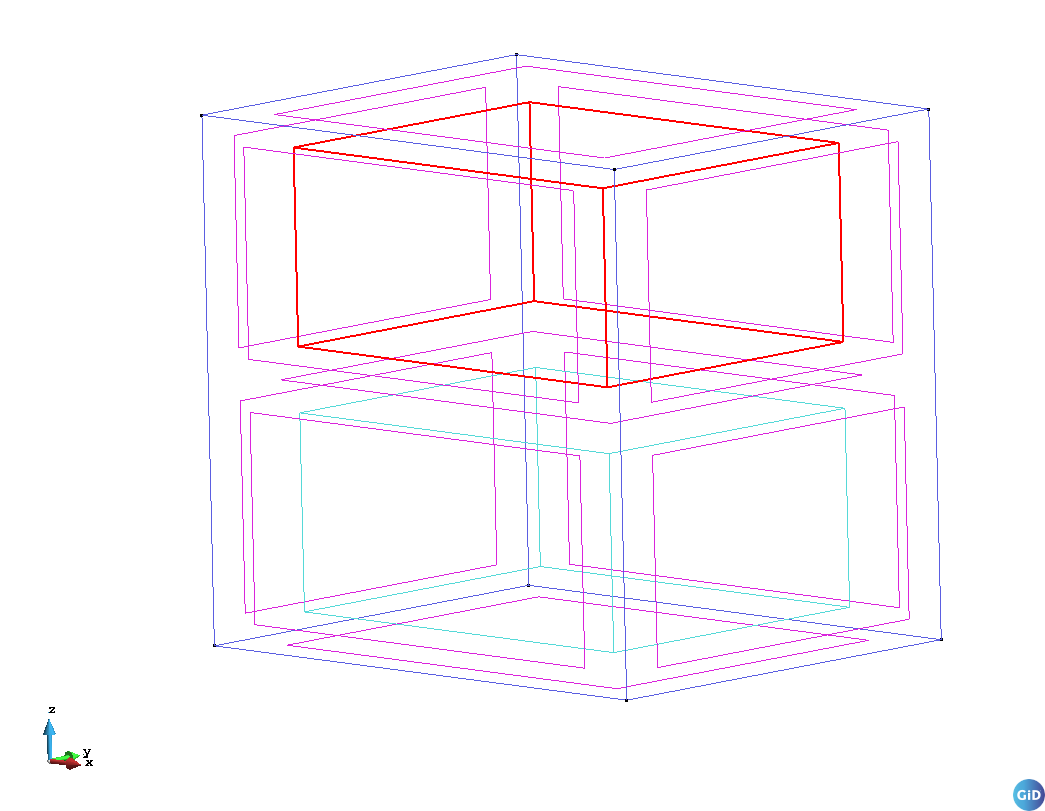

and select the cyan surface (in render normal can be selected more easy, or you can set on/off layers to aid the selection, or enter the id if you know its number)
You can visually see that now there are two volumes, e.g. one is selected in red
to identify what do you have in your model
you can send entities to different layers, list them, set on its labels, change render normal/flat, etc.
