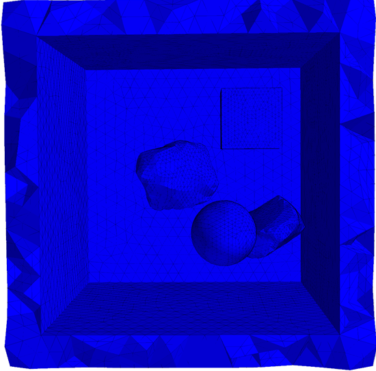

I’ve tried to create a bucket in a rectangular form and trying to assign it as a tetrahedral mesh. while no matter how many times i tried, once the bucket layer is under impact, the layer will deform or wrap on the particle that impacts on it.
How can i fix it? can anyone teach me on this issue?
Thank you soooo much
one screenshot for a bucket that should be created is been attached, which I got from a third party.

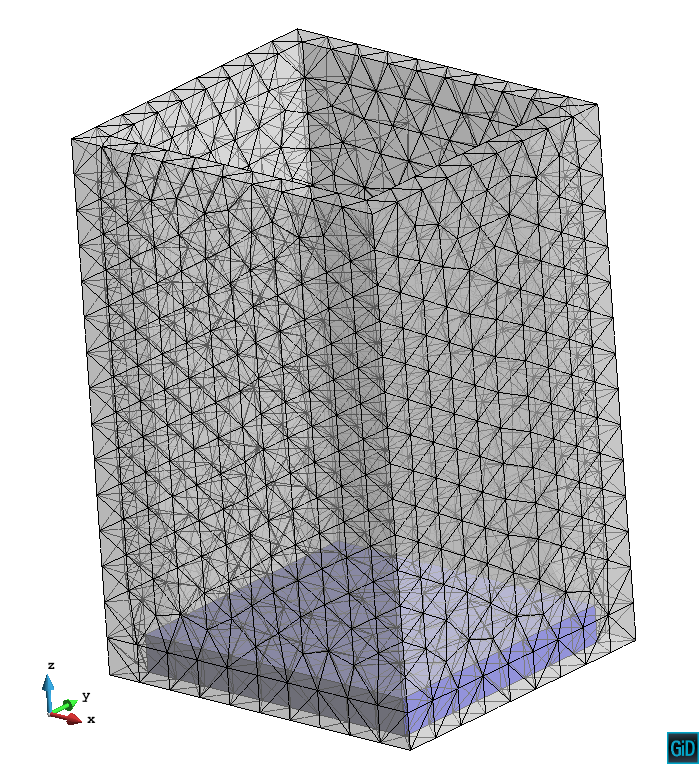

If I have understood well do you want to create a volume of a rectangular bucket and mesh it with quadratic tetrahedra.
for example I have created it creating first the surfaces of the base, a rectangle and a ring around the rectangle, and then I have created volumes by two copes with extrussion along z.
Then to mesh the volumes with quadratic tetrahedra must set Mesh->Quadratic type->Quadratic
and generate the mesh with a general edge size.
I attach this simple model
bucket_quadratic.zip (224 KB)
that looks like this picture

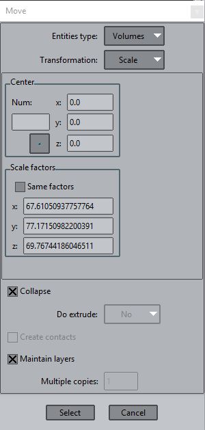

You can also try to modify my previous file using the Move - Scale tool to resize the volume scaling with different factors on each x y z direction
Utilities->Move…
Entities: volumes, Transformation: scale, and set the three appropiated factor to get the desired sized
measure the current size with Utilities->Distance)
e.g. my model has sizes 2.95812x2.59163x4.3 units, to have 200x200x300 the scales must be ex=200/2.95812, ey=200/2.59163, ez=300/4.3
I attach again the model scaled
