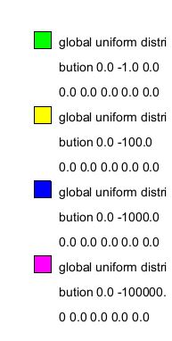

The problem is when the loop is done I find that the loads have all been assigned:
instead of getting replaced.
Also in the output .dat file I am not seeing the correct loading information.
