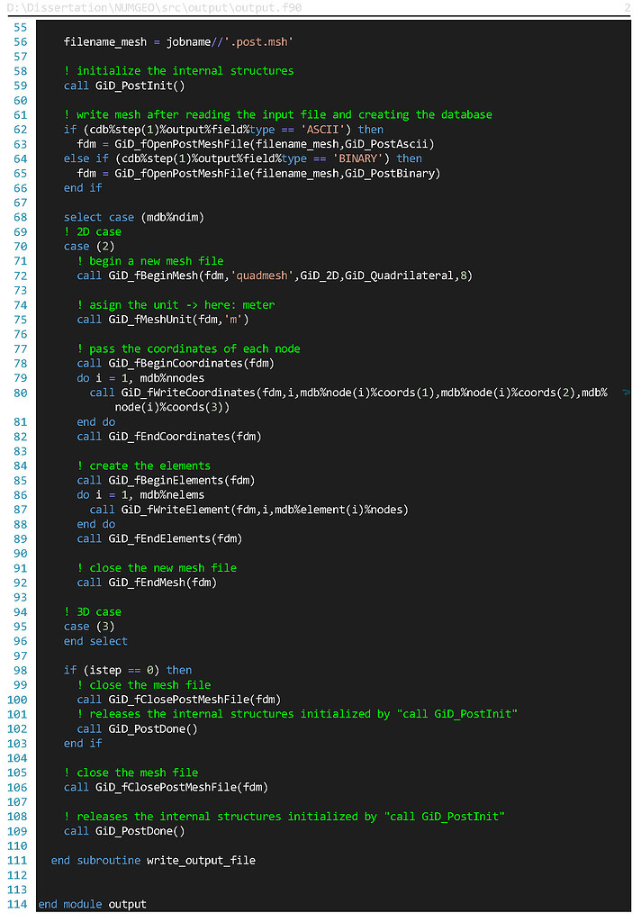

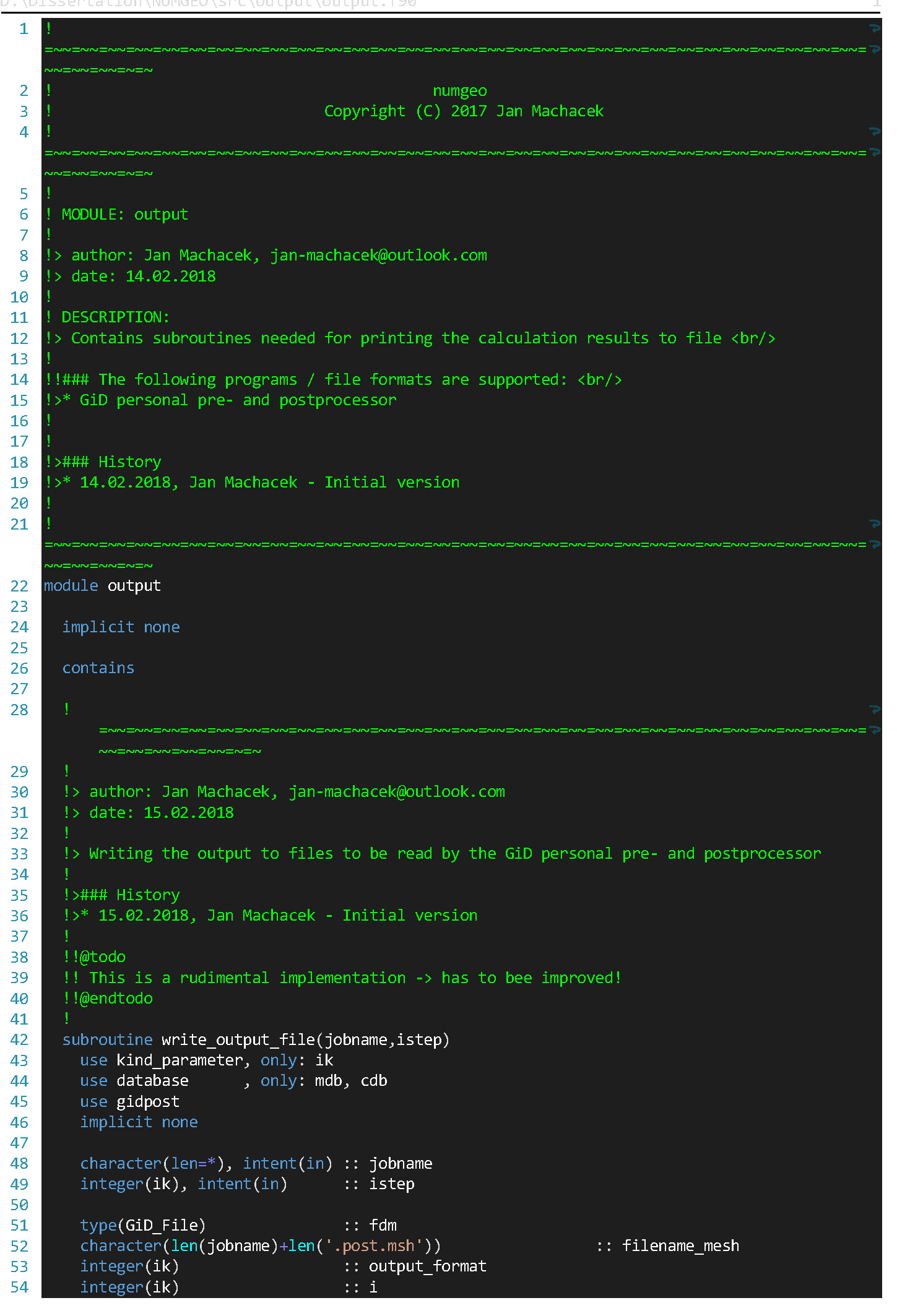

  2. Create a module output containing the subroutine write_output_file that loads the gidpost module: use gidpost

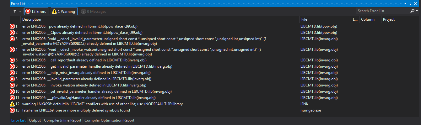

The errors can be seen in this here:

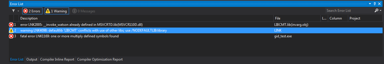

I also tried to compile and run the provided example testpost_fd.f90, but the results are similar:
i actually tried also to just dump the *.lib files in the source files directory. The roors were the same.
the fortran module can be found here:
Thank you!
Edit: Sorry, somehow the attachments were arranged wrong.
Try doing what the compiler has suggested:
specify to the linker to ignore one of the repeated definitions
/NODEFAULTLIB: library
to do it in Visual Studio go to the ‘project properties’ window
Linker->Input:
Ignore Specific default Libraries
LIBCMT.lib
and/or
LIBCMTD.lib
(I think that the version with D is because you are compiling a debug version)
try some combinations of libraries to be ignored, depending on the messages of your compiler
You can also compile the gidpost.lib library, the source code is provide (a C/C++ compiler is required off course)
and the zlib source code could be downloaded from Internet (it is open source) and recompiled also if necessary.
about hdf5.lib is also open source and can be downloaded and compiled, but its use is not strictly necessary (if you don’t want use this format), and is possible no to use it (commenting the #define HDF5 in gidpost_config.h)

You were right, the problems result from using a release version of the libraries in debug mode.
Excluding internal libraries did not work (the consequence was just a ton of new errors)
This did the job:
  • Recompile zlib.lib (and create a debug-version!)
  • Important: change the /MD flags to /MT (and /MDd to /MTd) to remove the overlap with internal dependencies
  • Recompile gidpost.lib (and create a debug version)
