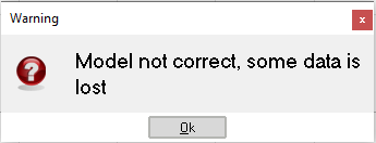

The problem is that when we open GiD with an existing project, we have, sometimes, a warning message saying “Model not correct, some data is lost” (cf. PrintScreen) and then Gid crashes after clicking “ok”.

I realised that this happens when the .lin file (in the .gid project) is “corrupted”. For example, if we delete the .lin file, the warning doesn’t show up anymore. However, as there is no more .lin file, we lost all conditions applied.
By investigating further into the origin of the problem, it seems that some data is missing in the .lin file (for example, if there are 35 conditions in my problem type, the .lin file has data for only 31 conditions). I have the feeling (although I am not sure) that this problem happens when the user loses his connection to the network and GiD tries to save the project on the network at the same time.

You are right, this message is related with some corruption of the .lin file, that store the values of the conditions applied to the geometry and mesh.
If this file become corrupted it is at least possible to not lost the geometry, mesh, groups, etc.
If the file is corrupted by some reason it is impossible to recover it (it is a binary file, and is some data is missing is not possible to know the meaning of any data)
In any case It is not normal that the file become corrupted, probably it happen related with the uses of the specific problemtype that your are using that provide some buffer overflow, and also depends on the exact GiD version used (and the exact version of the problemtype that maybe can also somehow bypass the problem).
I don’t think that the problem is related to a network problem while saving.
