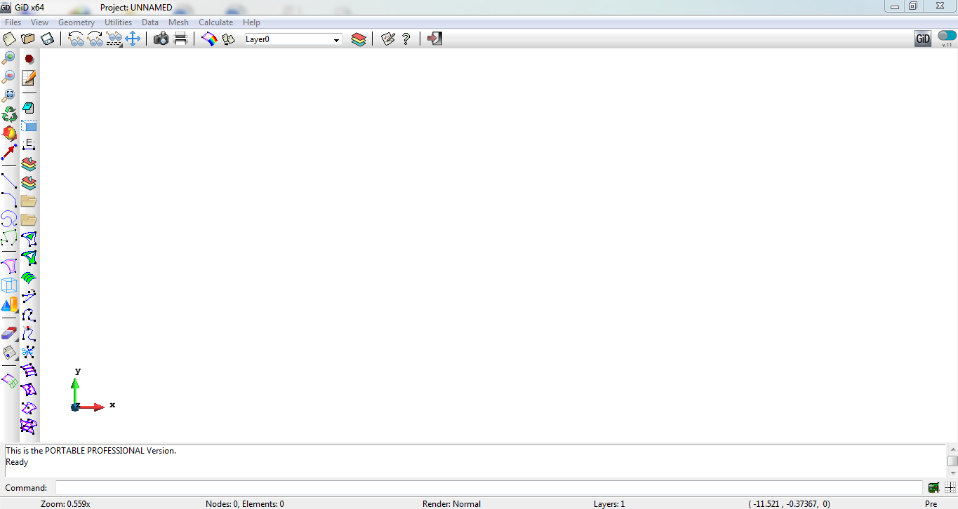

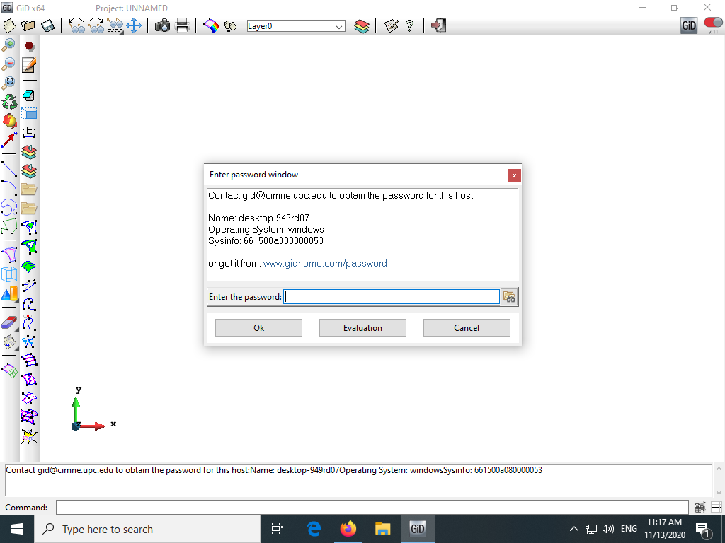

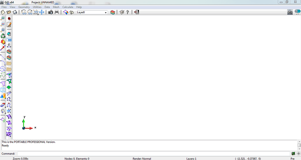

Many thanks for your reply. I checked my drivers and they are up to date.
When I use the USB on windows 7 it works perfectly fine and the top right corner icon turns into blue (the professional version). However, when I use it on windows 10 it remains red (unregistered version).

I have attached the images of the GID environment both in windows 7 and 10. Many thanks for your patience and kind consideration.

Ok, Initially I understood that GiD doesn’t work in your Windows 10,
not that it works but limited to academic limits, because your old password is not valid for the new operating system
Let me know the old Help->Register GiD… data showed by your GiD 11 installed in Windows 7 (or your GiD 11 licence number)
and let me know also, as text instead of as image, the new data (showed by GiD 11 installed on the new Windows 10)
