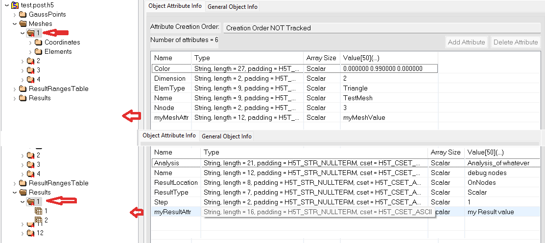

and the HDF5 output would be like this:

Update:
Before, i mentioned that when the output is HDF5, both calls GiD_fWriteMeshUserAttribute and GiD_fWriteResultUserAttribute should be used after GiD_fBeginMesh* and GiD_fBeginResult*, but for ASCII/binary output they can be used also before these GiD_fBegin*calls.
In the next gidpost version, when using HDF5 output, both GiD_fWrite*UserAttribute calls can also be used before GiD_fBegin (thus having the same behaviour for all outputs). The UserAttributes will be inserted in the Meshes and Results group respectively:
