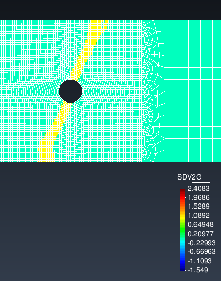

I have a variable (SDV2G) that is calculated at Gauss point level and its value is between 0 and 1. GiD extrapolates from Gauss point to nodes but when I visualise it, there are some elements that are greater than one or even negative, see the attached image. Post.res file has the following structure:

It is normal that extrapolating the values from ‘gauss points’ to the corner nodes its value is bigger or lower that the range of values on the inner gauss points.
for example imagine a 2D line element of 2 nodes (linear line element), using two equi-spaced gauss points for example with values 0.5 and 1.0 extrapolating them linearly to the corners will have values 0.0 and 1.5 (outside the range [0.5-1.0])
on the other hand maybe in your case the problem is another. attach your full case (mesh + results)
It seems that your are using hexahedra of 8 nodes, and writing results on 8 gauss points, then we are extrapolating to corners using the 8-noded hexahedra shape functions (bilinear). Basically we solve a linear system that has 8 unknown values determined forcing to interpolate your 8 gauss point values.
