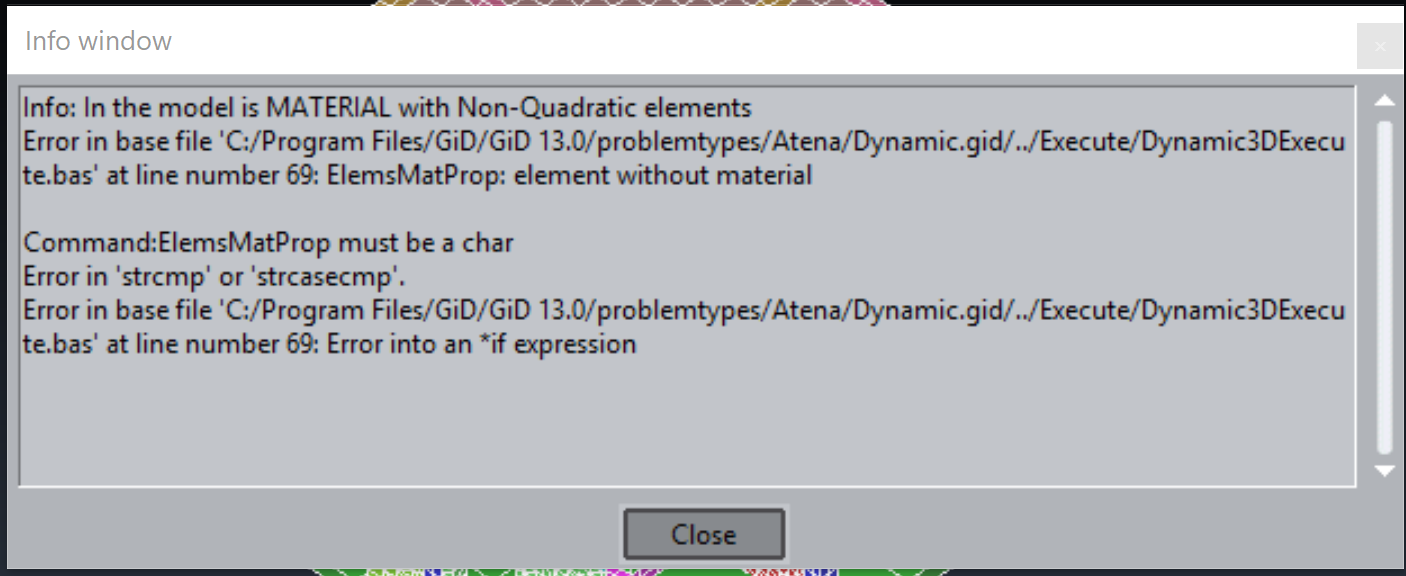

I am using Atena-GiD 13.0.2. The problem type is Atena-Dynamic. I have finalized my model in Gid 13.0.2. When I am analyzing my model in Atena-Studio. The following Error occur. please find the attached file, Here a .PNG file is attached which show the error.
I have tried my best to assign material to each element. but I don’t know, How to overcome this problem?? Please guide me in detail..

As you pointed it seems that some element does’t has material assigned.
The normal way is to assign materials/conditions to the geometric entities, and then generate the mesh (not directly assign it to mesh entities)
You can draw by colors the materials, to try to identify where is the material missing (material==0).
You can also list some entity to check if it has a material index not zero.
Maybe do you have some unwanted/unexepected mesh entities: e.g. a surface model with some unwanted isolated line (or forced to be meshed) that generate extra line elements. Check after mesh that do you have the kind of elements that you are expecting.
If you are unable to identify the entities without material, attach a zip with your example to have a look.

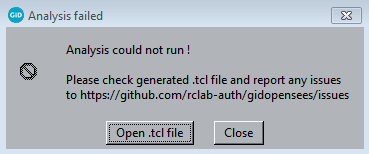

I’ve the attached 3D model, and tcl file is generated successfully, but when I try to run the model (which will use OpenSees.321.exe as recommended by GiD+Opensees) the following error comes up:
I’ve checked the tcl file, which is included in the model zipped file, but there seems to be no problem. I genuinely have no idea what to make out of this error message. Your help would be really appreciated.

Sorry, but this question must be asked to the GiD-OpenSees problemtype developers,
We are not users of OpenSees and don’t know how must be its input file.
I recommend you in any case to run the input .tcl file outside GiD in a DOS console, maybe some error messages are raised.
I guess that the problem is that the OpenSees solver is not properly installed, or it is not properly configured to be run from GiD-OpenSees when pressing the calculate menu. (maybe must set some environment variable, or set some path in the .bat file of the problemtype, etc.)
