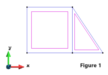

  1. The whole model is shown in Figure 1.

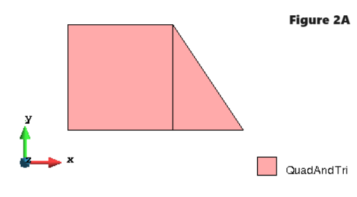

  2. The QuadAndTri group contains 2 surefaces. See figure 2A.

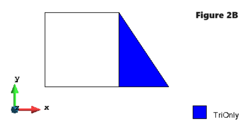

  3. The TriOnly group contains 1 surface; See figure 2B. The triangle face is intentionally included in 2 groups.
  4. Using the cmas2d_customlib problemtype assignment feature, 2 materials (iron and aluminium) are assigned to 2 groups.
    As a result, duplicate elements are created as shown above.

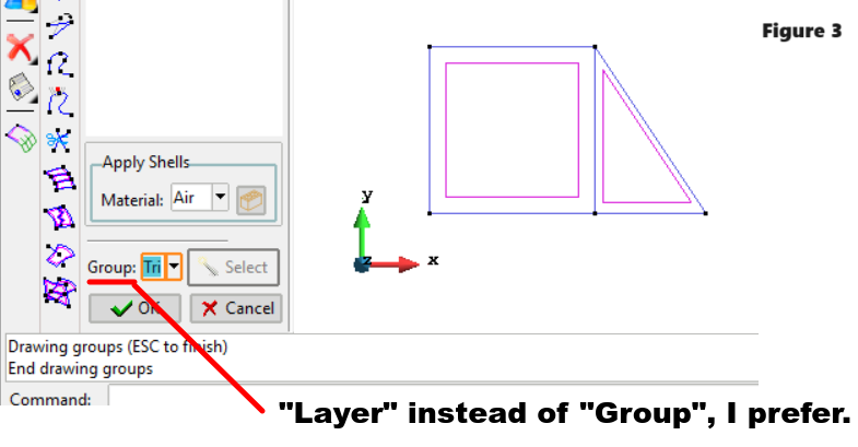

In order to avoid such problems, I think that the assignment using “layer” solves this problem.
See the figure 3.

Thank you for your reply. After reading your reply, I had an idea:
Please add a new feature that can automatically convert all “layers” to corresponding “groups”.
Background:
My main concern is to build a complicated 3D model from many volume geometries.
When assigning material properties to each volume geometry, the “overwrite” feature is useful.
For example, consider a dam model where the model contains concrete, water and rocks.
My approach is to first assign water to whole volume geometries,
and then change some of it to concrete and rock.
If there is an “overwrite” function, this method is useful if the model geometries are complex.
GiD “layer” includes “overwrite” feature but GiD “group” does not include “overwrite” feature.
So my idea is:
(1) First, build a model by assigning “layer” to each volume geometry.
(2) Second, create “groups” by converting “layer” to “group”.
Creating a “group” from a “layer” is easy within the GiD operation.
But if there are many “layers” in the model, repeating this conversion process each time is very tedious.
So if there is an automatic conversion feature from “layer” to “group”, it will be very helpful.

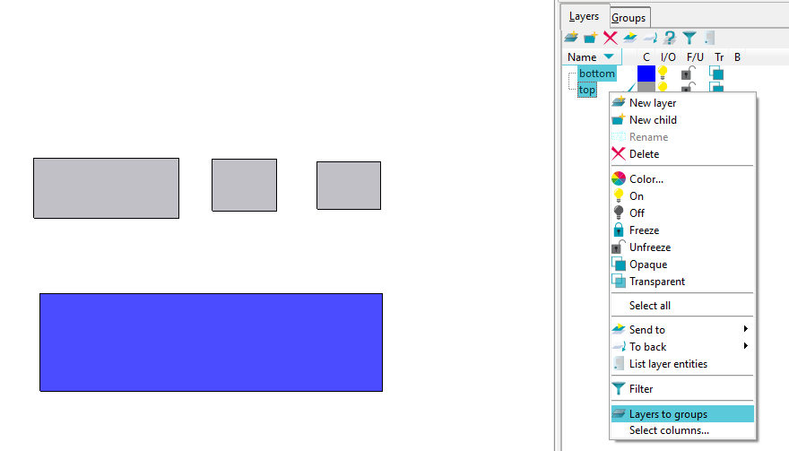

This feature already exists
in the layer window select the layers you want to create groups, and in the contextual menu select “Layers to groups”
(and in the groups tab there is the opposite, create layers from groups)
but take into account that are not the same kind of structure, the relation is not 1-1 always
