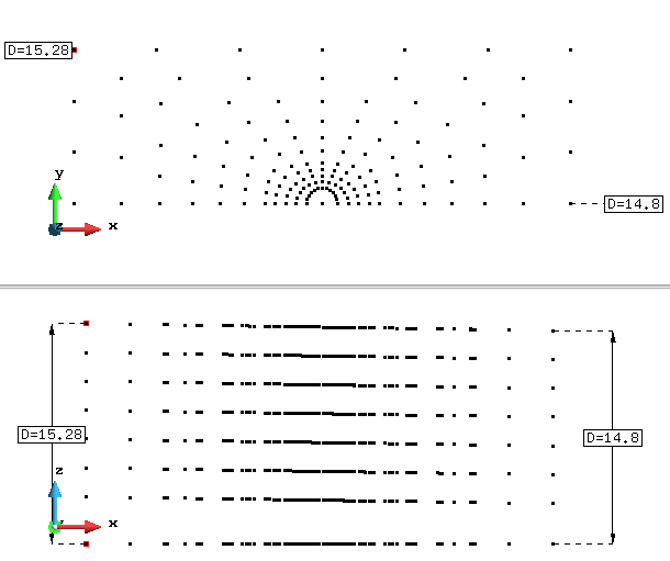

Note that I don’t want to use the extrude feature when copying points to another z level to draw vertical lines, because the distance between points in the last layer is not identical. In other words, points in z=0 have a 0.85 degree inclination but the ones in z=-14.8m level have zero degree inclination.
Here is the screenshot of xy and xz views:

It doesn’t exists any tool to automatically create the lines you want.
You must create your own Tcl scripting proc that ask for the points to get its coordinates, and find the clusters of points ‘close with a tolerance in x,y’, sort each cluster by z and create the new lines connecting them
