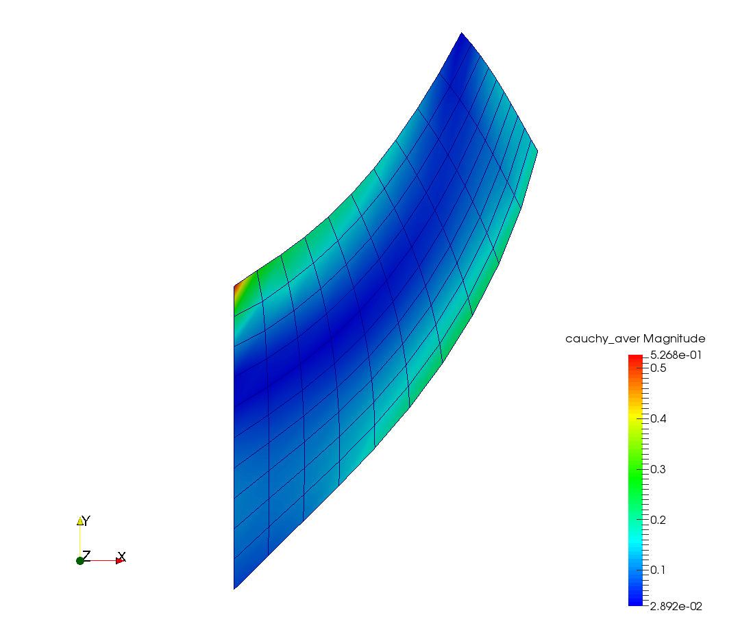

I would like to display the grid of a 2d result (4 noded quadrilaterals) as shown in the first attachment. I was able to do this in older version of GiD, but with the latest ones I can only see the boundary.

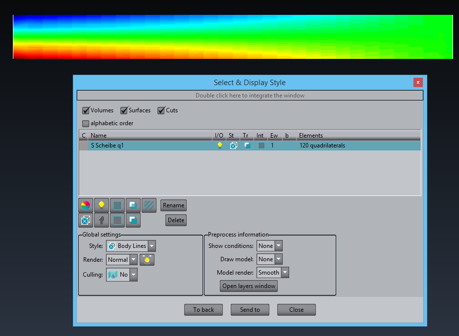

I use view style: “Body Lines” and the option “interior of Set … will be drawn”.
Where is the option to turn on the grid??

you are right: I can see the grid after rotating and also when selecting isometric. Only for “Plane XY (Original)” the grid is missing.
