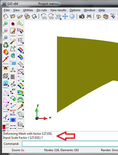

when you select a deformation, GiD selects a factor that allows you to see the deformation.
the factor can be seen at the command line, just below the graphical window:

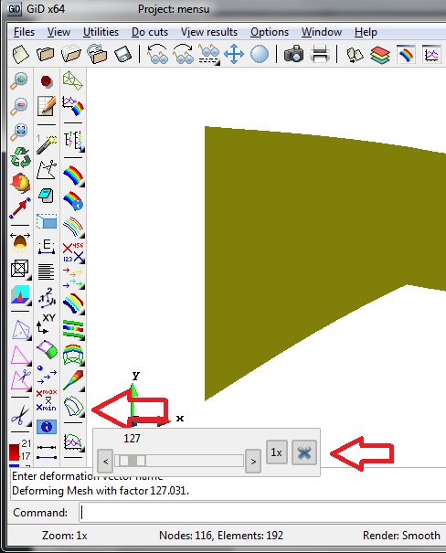

Also if you use the deformation icon, a scale appears allowing you to choose the deformation factor:

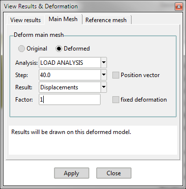

You can also set the deformation factor using the Windows–>View result window, together with other deformation options, like setting a fixed factor for all results with the same name ( for instance, always use ‘1’ for displacements):
