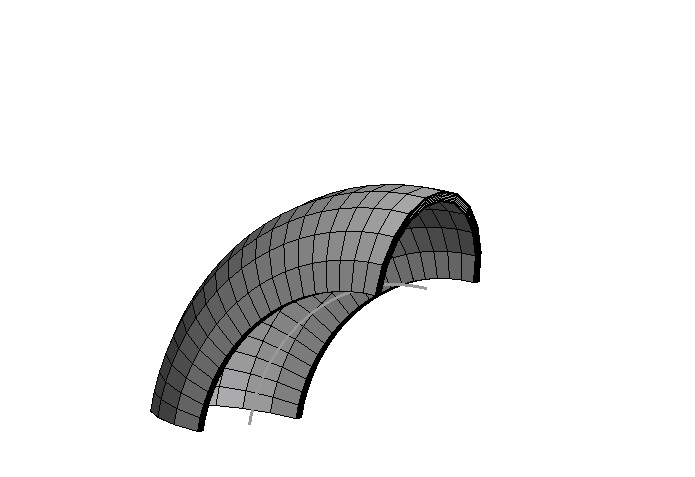

Is it possible to mesh this part ONLY with hexahedra elements? I assigned the element type hexahedra, but GiD generates linear elements, too.
I’ve managed it. The problem was that I didn’t erase the line that served for sweep operation and GiD automatically added linear elements to that line. Sorry for disturbing :slight_smile:
