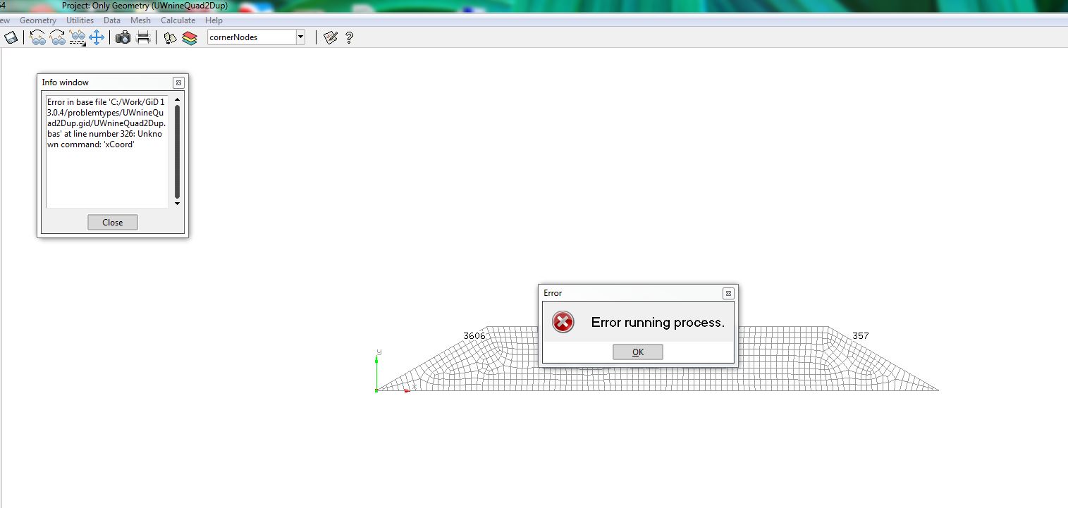

I have created a model using GiD software and assigned the nodal conditions and constraints successively (using OpenSees as a problem type)! However, when I press the calculate button to get the tcl file, the error message in the attached picture pops up! Kindly, can you advise on this?
Kind regards
Bashar

About your error, the image said that there is a bug in the file “UWnineQuad2Dup.gid\UWnineQuad2Dup.bas” of your problemtype, in the line 326
This .bas is the template used to write your calculation file (a file with Tcl code syntax in the OpenSees case)
Casually I have an old copy of this problemtype (maybe is not exactly the same as your copy) and this line has
node *iNode *xCoord *yCoord
that try to print a variable named xCoord and the error is that previously was not set to a value (because is set in some conditional code)
*set Cond Dashpot_properties_and_slave_node *nodes
*loop nodes *OnlyInCond
*if(cond(1,int)==1)
*set var dNode(int) = NodesNum(int)
*set var xCoord(real) = NodesCoord(1,real)
*set var yCoord(real) = NodesCoord(2,real)
*set var C(real) = operation(cond(2,real)*cond(3,real))
*set var mRho(real) = cond(3,real)
*set var baseArea(real) = cond(4,real)
*endif
*end nodes
If there is not applied the condition named Dashpot_properties_and_slave_node over any node the error will be raised.
(in fact it seems that the value will be arbitrarily the x of the last node with this applied condition)
