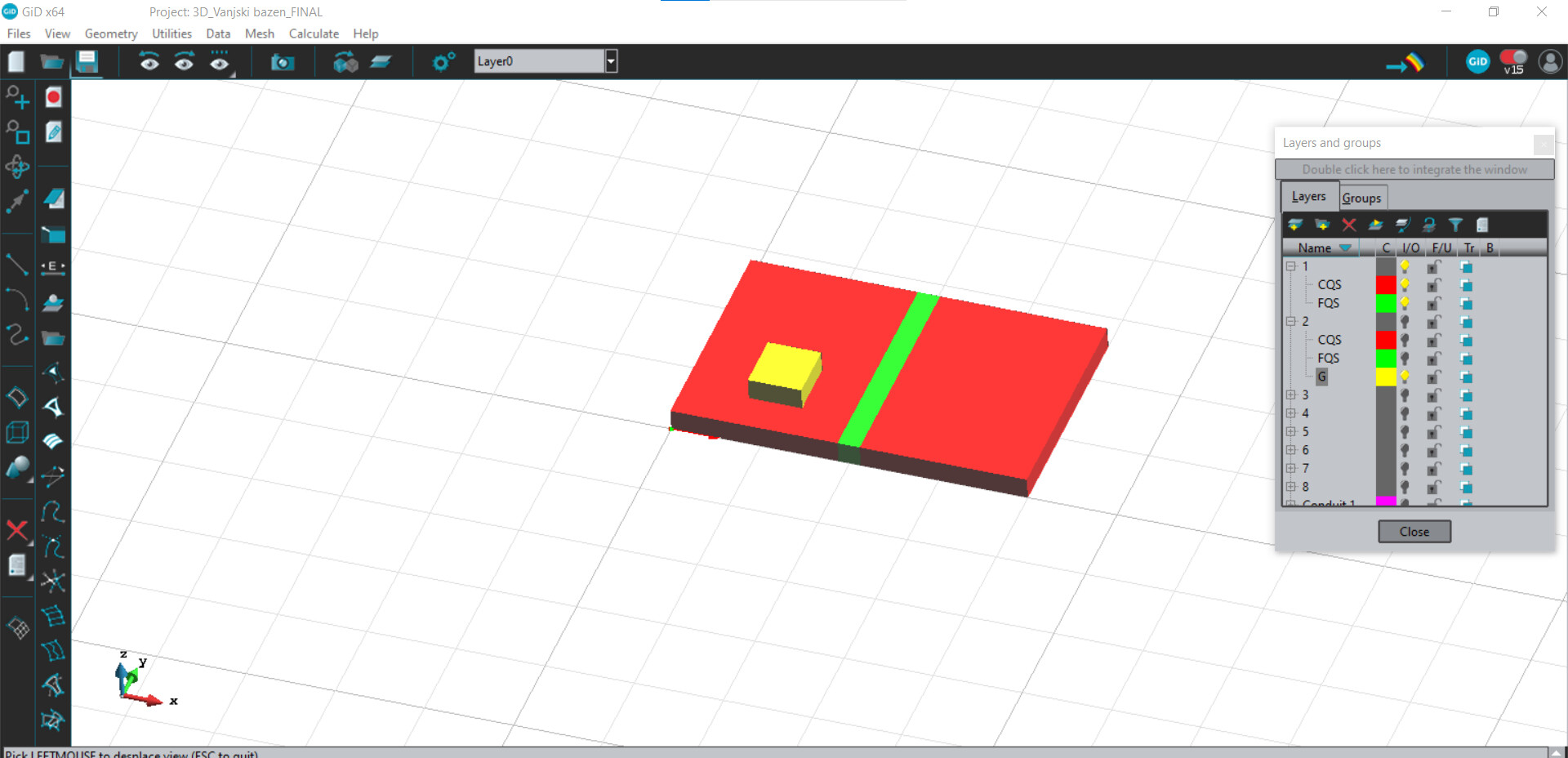

I have problem defining the contact volume between two “layers” of volumes with different dimensions. The contact between two lateral volumes was successfully made, however, when the two volumes are above each other, they cannot make contact.
I am asking for feedback on how to solve this problem, i.e. how to connect volumes that “stack” on top of each other.
The 3D scheme can be seen in the picture below.

Do you want to create a ‘GiD contact volume’ between the big rectangle (red) and the small rectangle (yellow)?
Then probably you don’t need a ‘GiD contact volume’: this concept is like a kind of ‘mesh criteria’ to force the mesher the creation of 1-1 paired nodes in both surfaces, and flat elements connecting them.
but both surface must be ‘equivalent’, this is not your case. the sizes of your surfaces are too different.
This kind of meshes are used sometimes to force ‘periodic mesh’, and usually to simulate bodied contact (this is the cause or the current name).
And what is the simulation program (which GiD problemtype) that you will use?
Each program can require different approaches for its physical simulation of contact between two solids. Probably this program don’t require a 1-1 nodes relationship, and simply require some boundary condition that mark a region of a body as ‘master’ and another of the other body as ‘slave’
If the simulation really require 1-1 nodes between master and slave then you can divide your big rectangle into a small rectangle and a big ring rectangle holed with the curves of the small one, and then can create an extra contact volume between the two ‘equivalent’ small rectangles
