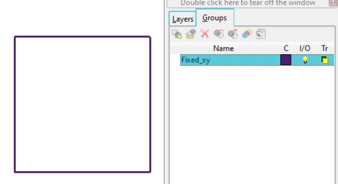

I need to define a boundary condition (fixed displacement in x and y directions) for a group of lines. In this way, I created a group with the lines that I want to apply this fixed displacement:

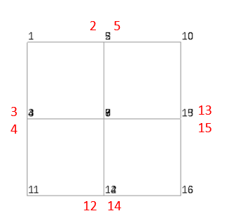

Duplicate is a rare meshing feature, and it seems that some duplicated nodes are not assigned to the groups.
This is really a bug, it must inherit the group from the geometric entity.
