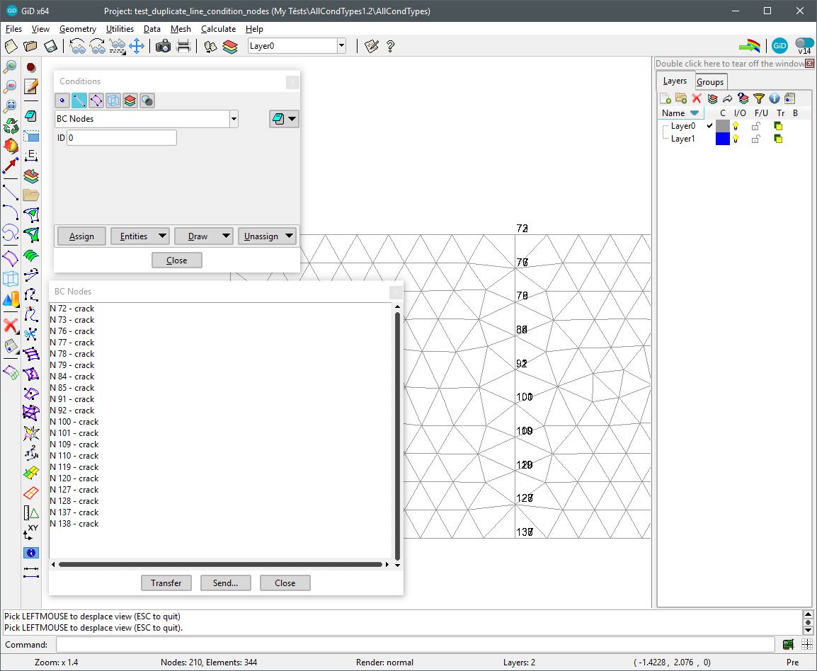

I attach a simple example, a rectangle divided in two surfaces, sharing a line.
I have set this line ‘to be duplicated when meshing’ (Mesh->Mesh criteria->Duplicate->Lines)
and I have assigned to the line a condition (of a testing simple problemtye), named BC_Nodes, over lines->over nodes
Then when generating the mesh the nodes are duplicated (you can see visually with: View->Higherentities->Edges)
and In the condition window if I list (‘Entities’ button) I can see that there are 20 nodes with the condition (10+10 twin nodes)

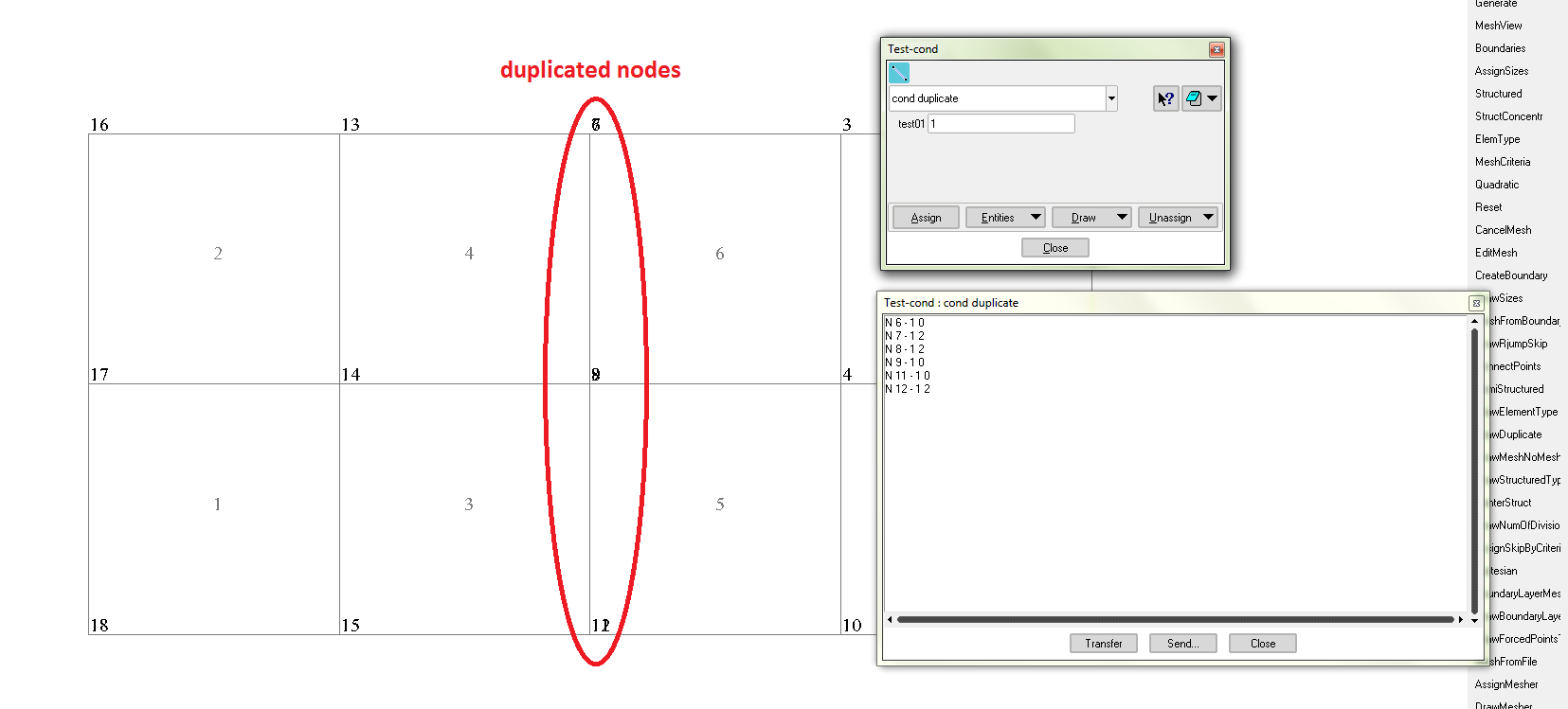

You are right, this is not a problem of GiD Version. I have found why it’s not working. Since we use GiD 14, we have added some code to a tcl file before meshing. This code changes the IntervaData value (GiD_IntervalData set) to a value different from 1. When the value of the IntervaData is equal to 1 before the meshing command, the condition is applied on both twin nodes but when this value is different from 1, the condition is applied on only 1 of the twin nodes.
We have changed the IntervalData to 1 before meshing and now that works fine.

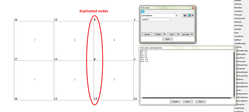

But I have another question:
