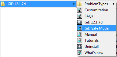

Please try to start GiD safe mode (you can find it in the installation folder, and also can be reached from the start menu) and check the option Reset preferences.
