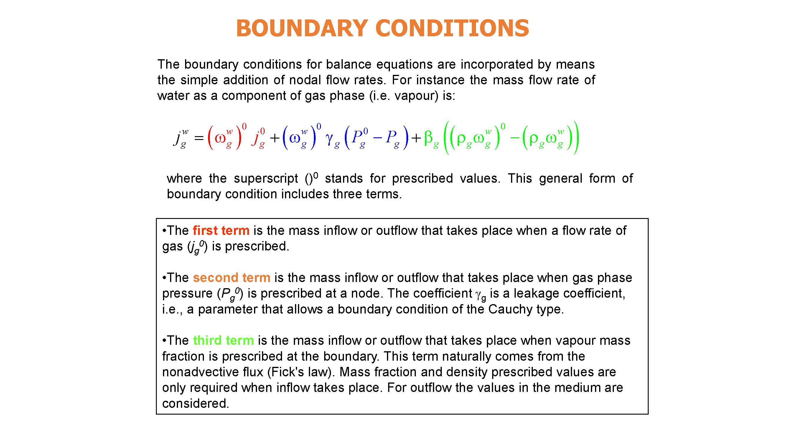

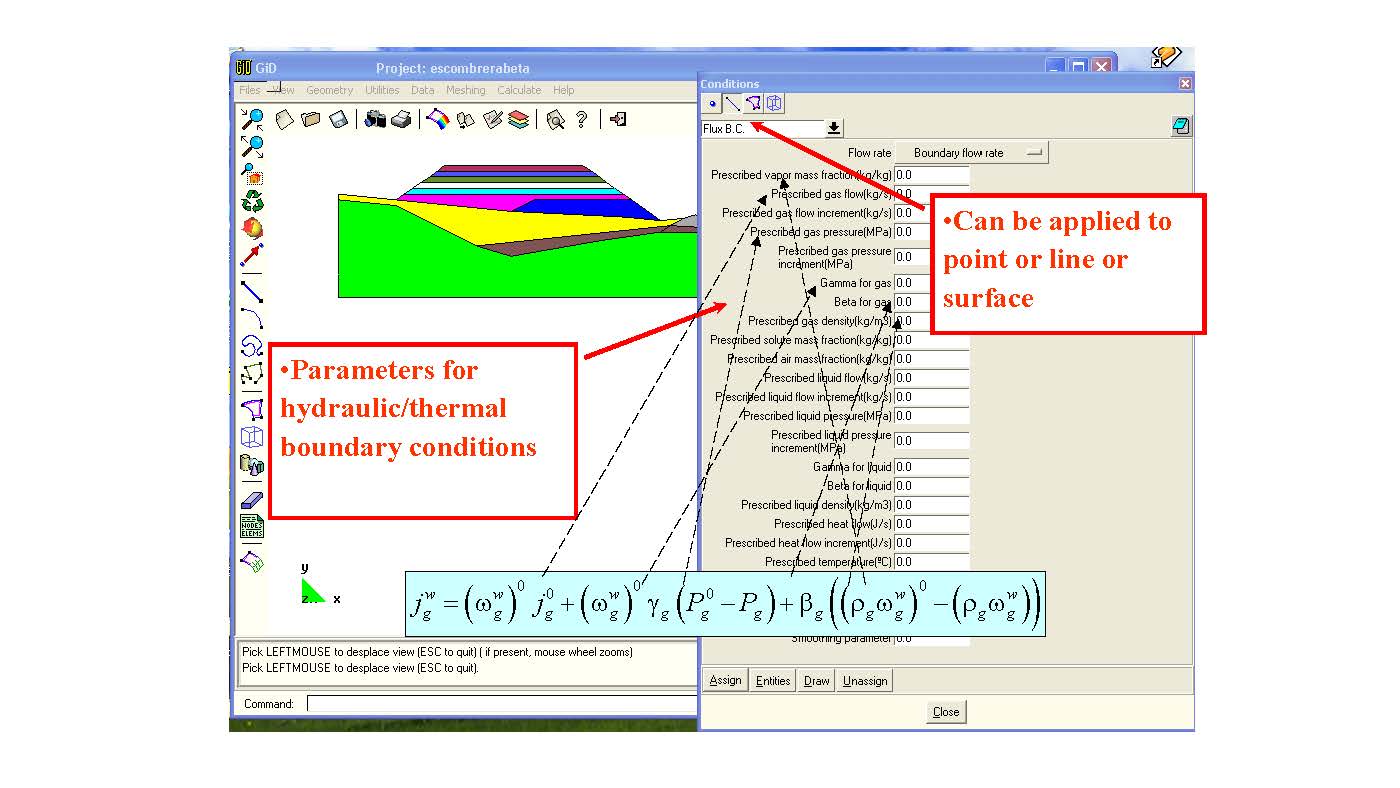

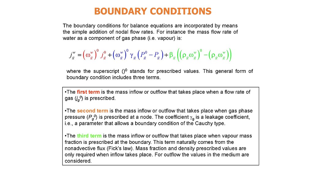

My question is related to the CO2 properties given in case of injection. The carbon dioxide properties are given at the flux bc in terms of gamma for gas. What exactly is this gamma? I guess it is not specific heat ratio as its value is 1000 in some cases in the tutorial problems. Also how does CO2 differ from air in terms of the input values for gas?
Further, how do I vary the CO2 properties?
Please find attached a brief explanation for the gamma for gas.
